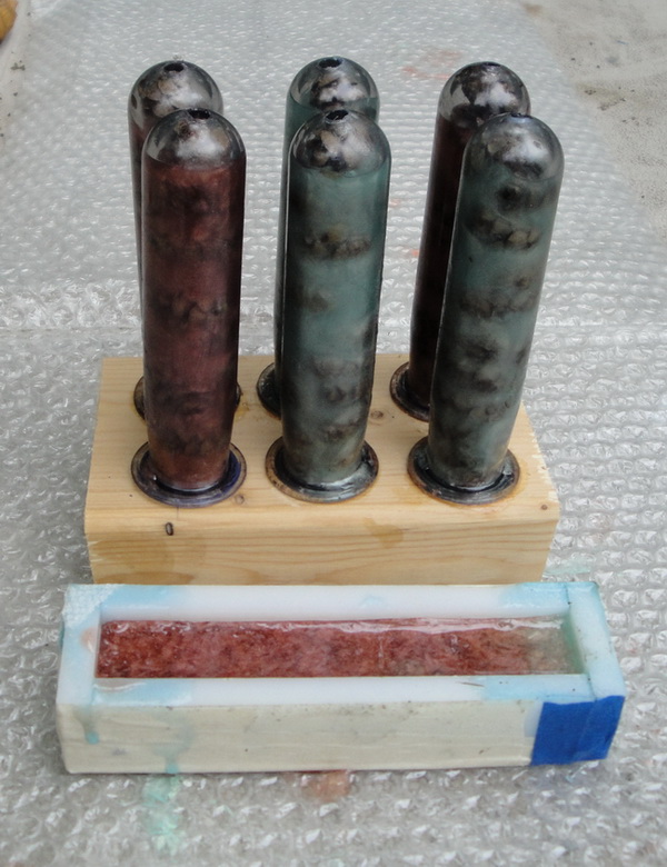

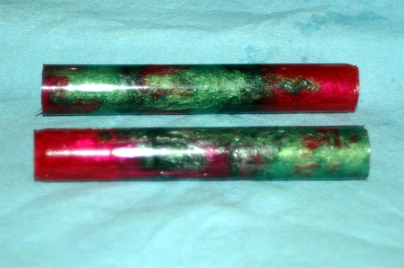

I figured a new way to vertically cast where you can see what your pour looks like. By using "baby soda bottles" you end up with a heavy duty, absolutely clear and smooth tube to cast in. They can be got at

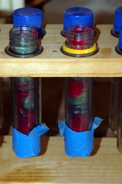

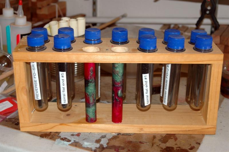

stevespanglerscience.com/product/test-tube for $10.00 for a bunch of them. Cut the very bottom off the tube and use 2 pieces of blue painters tape to seal it back up. Do your pour, mix your colors the way you like them and then let them cure. I use PR. After they cured take the tape off and pop them right out. They come out extremely smooth to you don't have to touch them with a tool, like PVC, to see what they look like. The attached pictures should explain everything. I've been using these tubes to store scroll saw blades. They work for this also. I used Pam in my experiment on 1 tube. Both tubes released exactly the same so at least in the beginning a release agent isn't necessary. I've only done 1 pour so far. The finished blanks are 5" long and 7/8" in diameter. It takes about 2 oz of PR to fill the tube. Your mileage may vary depending where you cut the tube. You could also mark the tubes and do a short cast for pens like Sierras. Any questions just let me know.

no they are not glass. they are actual soda bottle (2 liter size) in the shape just prior to going into the mold. the top even accepts 2 liter bottle caps to seal. wonderful idea. virtually unbreakable and completely recyclable.
The best thing about it is you don't have to touch the blanks with anything when you get them out of the tubes. They are very smooth and nothing has to be done. They look polished in the photos but that is them out of the tube.

I have made about 3 dozen blanks with mine. I cut the ends off two because of the deep ridge in the mouth on a couple. The other 13 tubes I left the ends on and sprayed with mold release. A few taps around the tubes and they slide right out. If you are planning on making designers or similar length pens, you need to leave the ends on and pour to within a quarter inch of the top for it to be long enough. If you cut the ends off the blue tape works fine to seal it up. Can't answer your question about the pressure pot.
I cut a hole in the bottom and taped it so I could pour from the top. I then put the lid on and placed the tubes in the rack upside down. I removed the tape so pressure could get into the tube and placed the rack in my pressure pot at 50 psi. The blanks are cast mini pine cones. It turned out pretty good and as far as I can see the caps were not damaged.

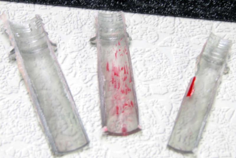

Well tonight I did my first cast in these tubes with Alumilite. I cut the rounded part of the tube off and put the cap back on poured from the bottom and placed it the pressure pot.
They are STUCKKKKKKKKKKKKKKK and will not even budge a little. After spending the last half hour trying everything to shock them out of the tube. No luck. I even put pam
spray in the tube before the pour.
I am now going to try to somehow heat the tube and hope it expands enough to get these out.
as of now I would say NO NO NO you can NOT use alumilite for these!

It is later in the evening. I placed both tubes in a heat sealed bag and in boiling water to see if the tube would expand.
No luck
I ended up cutting the tube down the length on 4 points. Two of the pieces came off and the other two I had to use a chisel and hammer and finally got they to come off. The Alumilite had eaten into the inside surface of the tube.
So I guess this shows that these tubes cannot, for sure be, used with Alumilite.
I'll post pictures in the morning.
Oh well
Alice
It is morning and here is the picture of what is left of the tube. One section is MIA because it flew so far when I was chiseling it off I do not know where it went!
I might have salvaged the blanks in all of this.. while cutting the tube off I accidentely made scores in the side of the blank. I am hoping that I can get something turned and avoid the cuts.
