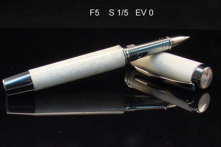

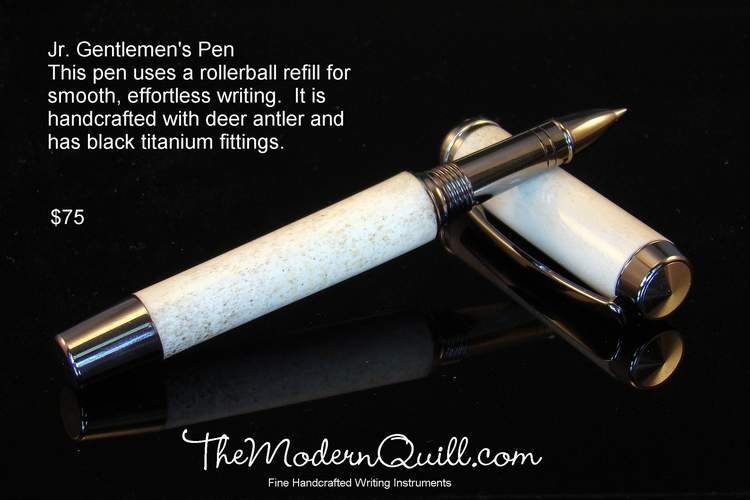

Thanks for the comments on my first picture in the post 'New Camera Test'. I tried to follow the suggestions as close as I could and this is what I came up with. Any better?
Exp. = 1/60 fStop 3.2 Exp Bias -1.2
This is the photo from the previous post:
Exp. = 1/80 fStop 3.2 Exp. Bias 0
OK, you are making a bit of progress. Next thing to try is a polarizing filter on the front of you camer lense. This will also enhance some of th depth of color in the material being photographed. These filters do not usually give much changes if the light source is fluorescent lighting. Try using sunlight fo best results with the filter. Also, post your shutter speed and F stop used for the pictures you post. This will give many of the more versed photographrs out here a better idea of what you are doing and/or have done. Just don't give up on this project it will be worked out. [:D]

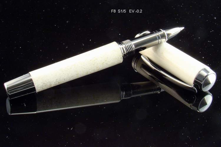

Here are a couple more shots taken at F4 and F8. I did have to move my light tent because my wife didn' like it on her dining room table, that may have made some difference in the lighting because I had a big window beside me there.
I got some sort of reflection (I think) on the top of the cap and on the nib end of the pen.

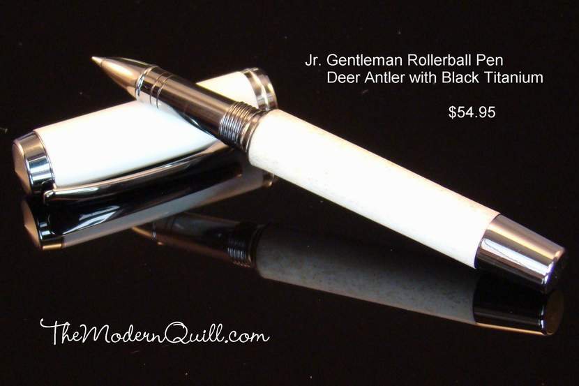

With different lighting. A 500 watt halogen light on either side of the tent.
<br />
Steve, might I suggest that you change from the completely black background? Being the predominate area of the photograph it can and will influence the exposure the camea is selecting. If possible try a non reflective background. You may not see it in the camera yourself or in the photograph but something is causing the whiter areas to stay a bit overexposed and thus washed out.
Whatever you change will give cause to reshoot all your testing. The picture with the 500 watt halogens is picking up a lot more detail in the form of little white specks in the background vs what is showing in the picture before it. There is a lot more going on inside your camera than I am familiar with so I am addressing your problems with a knowledge of light and the colors from the bulbs, exposure settings, etc.
I use a Nikon D-1 with all kinds of lenses for my photography. The camera gives me complete control on exposure, shutter speeds, types of lighting, kind of "film" used (daylight, IR, etc.), so I have a complete range of options that I do not believe are present in your camera. I am trying to adjust what is available for your setup using a set of rules that apply to all cameras. Do not give up, if nothing else applies you are getting about 38 years of photographic techniques that I have employed all my adult life. Things have definitely changed and some are better, yet new problems need to be addressed. WE WILL GET THERE!
