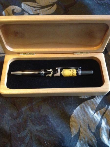

Welcome from Indiana! I recently made the police version of that for a retiring police chief. I put it on an Elegant beauty Sierra from Berea per the customer request. I hope the pic shows up. I'm using forum runner and this is the first time I have tried to post a pic.
Thanks everybody, already got some great advice and some great ideas. Richard, that looks great, I like the box too, very nice. Harry, I agree, it seems like if it's not on here it's because it doesn't exist.

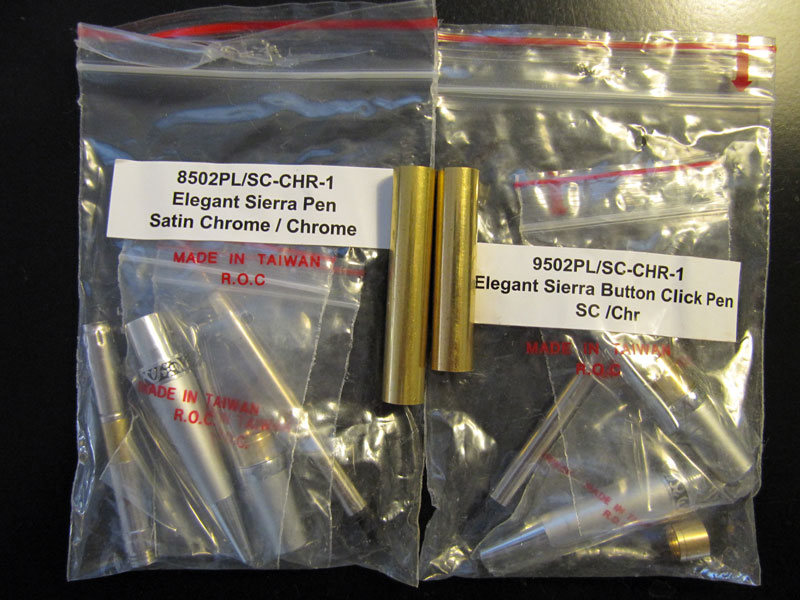

The Elegant Sierra twist tube is 2.21"
The Elegant Sierra click tube is 1.90", this kit is out of a new shipment from Bear Tooth.
