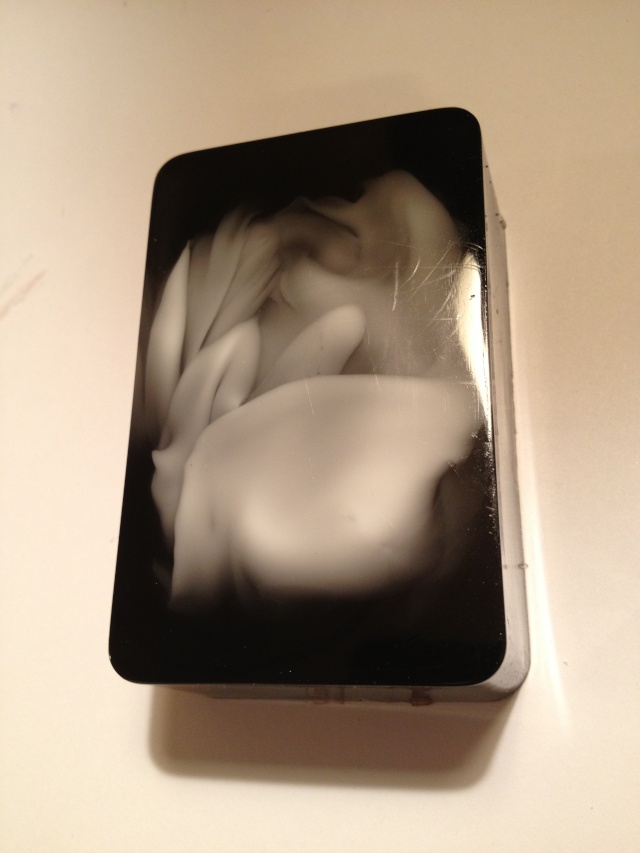

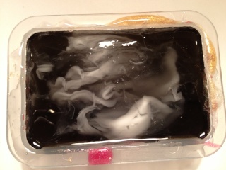

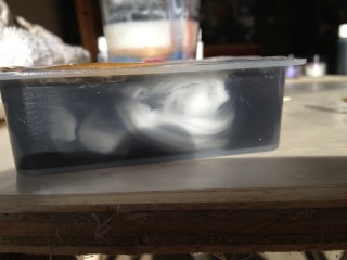

Translucent Black with white:

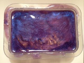

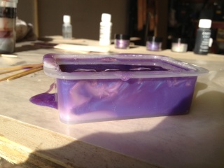

Purple Bronze, Misty Lavender, and Interference Violet.
Yes, My first three color pour!!

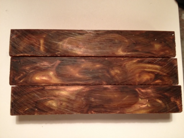

Finally, I actually made this one a few days ago but I just cut it up. I believe its my best one to date. Copper and Gold:
Looking great. Looking forward to seeing them in the round.

That is going to be nice. On the left, it looks like a hand with feathers on it holding a childs hand on the right.

Cant wait to see that black and white...very,very:cool::cool:
Thanks. I can't wait either to see what they look like after turning. Got them cut up, drilled, tubes and blanks painted black for tomorrow.
