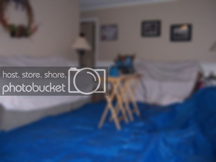

I would suggest a Jet Mini or the Delta Midi if you decide to get one anyway. I have used both and still have the Delta, both work great for anything that will fit on them it seems. A lot of people seem to have done what I did, start with the mini/midi and then get a "full size" lathe. I wish I was closer to Huntsville and I would loan you my Midi for the summer. I don't use it for much since I got a bigger lathe, but I also don't want to sell it for $1.50 at a garage sale. I would be glad to loan it but I live about 7 hours from H'ville. I do have a BIL that lives near Huntsville and we do see each other occasionally. Just a thought- [:)] I would rather see you busy on the lathe in your free time than waiting for the MWR people to open up. [8D]
Here you go:
