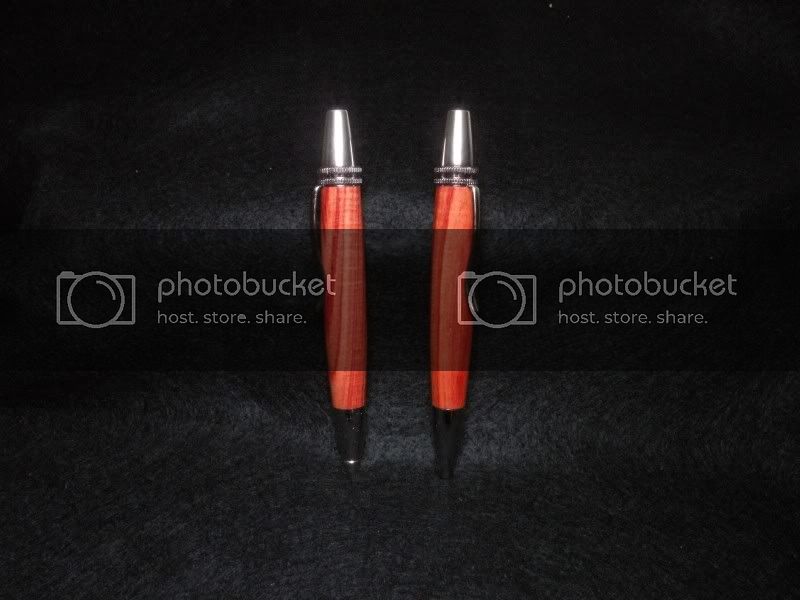

I made a set from the Sierra And Serra click pen. I used black chrome plating with black acrylic I have been using them for 8-9 months and had NO problems.
