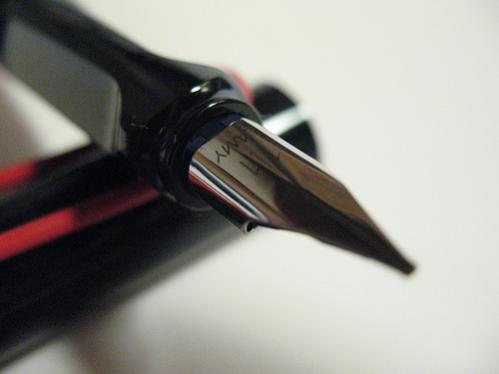

I must first admit that I know nothing about calligraphy and therefore depend on others for their knowledge. To my untrained eye and according to the customer, the nib was as round as a regular fountain pen nib. (She all ready owns 3 or 4 regular fountain pens from me.) Your first description sounds like what the customer wanted but she says that is writes just like a fountain pen. I did not take a picture of the nib so I have to take her word for it. She did send me picture of the type of nib she is looking for and I will include it here. Thanks for helping me.
Anthony (Penworks) sells, or used to sell the Lamy Safari with the 1.5 nib, which is the pen in the photo. I would contact him to see if he carries a nib that will fit the large feed used by Craft Supply or if he would grind one for you.
In case you are curious, the nib in the Safari will not fit any of the kit feeds without some serious modifications.
