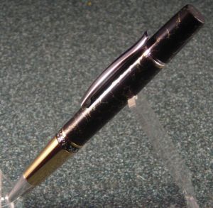

Here's a size comparison pic, both have Black Ti finish.

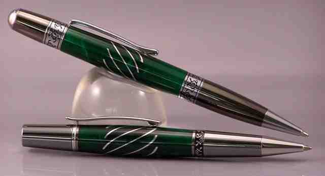

Another vote for the EB here as well . It's thinner and shorter then the Sierra , plus it has more meat on the tube (smaller tube dia) . It's also finial operated and takes a parker style refill .
Here's one that I replaced the stock finial with a custom one .
