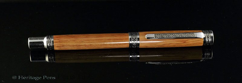

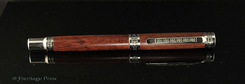

Huanghuali (huang hua li, huang huali)
Zitan
These are some of the most expensive woods in the world but not particularly difficult to turn or finish.
