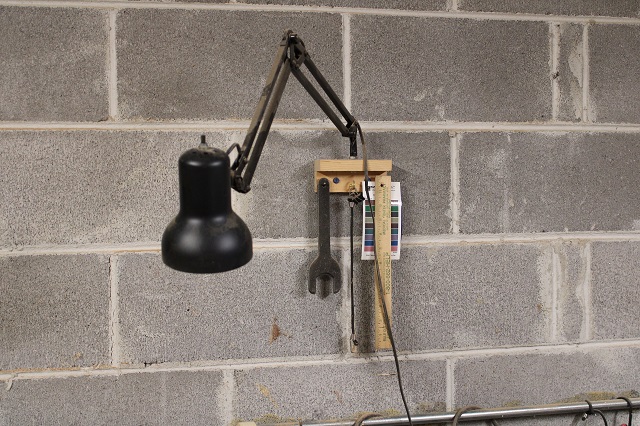

I don't have a photo but I use a clamp-on desk lamp mounted on the wall over the lathe.

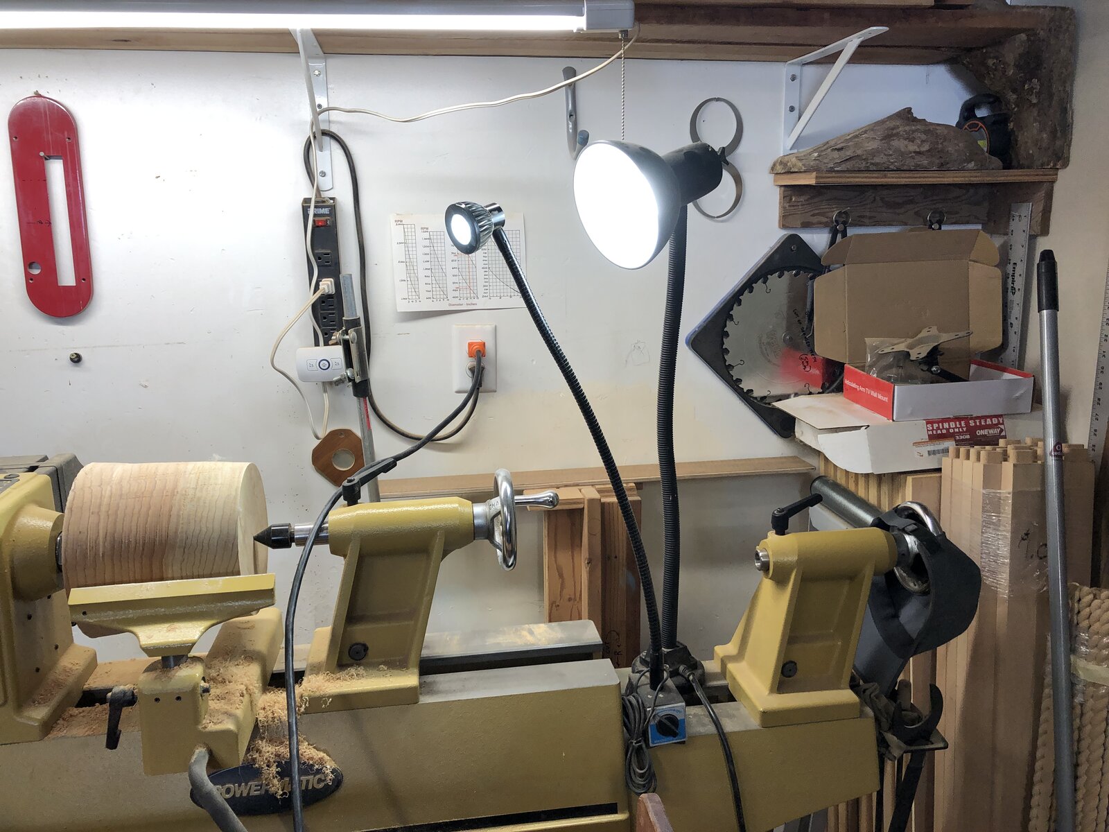

Here are a few ideas I have incorporated for lathe work lighting. Notice there are three lights. An LED tube at very top for general lighting. Also two gooseneck/mag base lights. Why these? The tube light is plastic, thus will not shatter like glass. Both goosenecks are LONG, 27" base-to-bulb. One provides a more diffuse beam, the other more focused. The mag base allows max flex for positioning just where it is needed. Maybe one or more of these solutions will fit with your needs. Sorry, but do not have model #'s.
EDIT: I just realized this is an older thread. But happy to provide the info. I would not change my setup shown, it provides excellent lighting no matter what configuration or project I have on the lathe.
