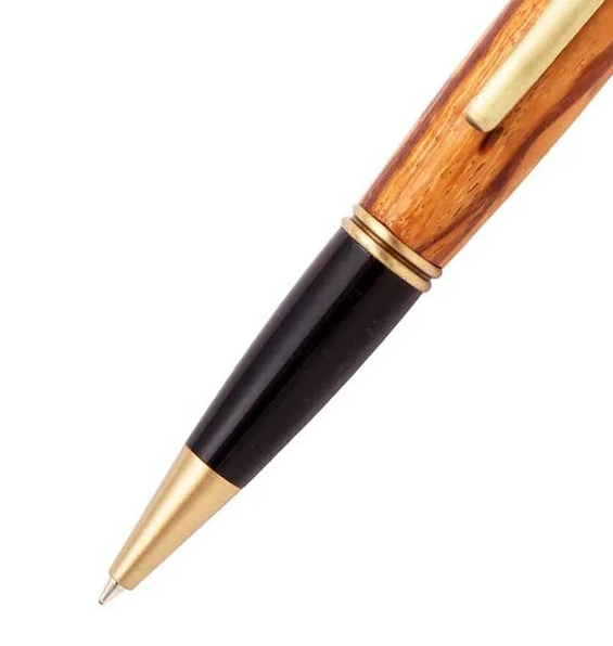

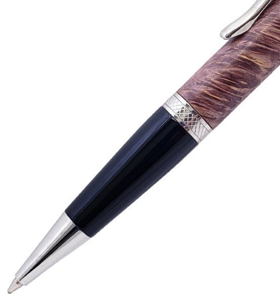

Price friendly does not generally mean beginner level, but I definitely understand where you are coming from. Most "starter sets" come with slimlines. You can find them for $2-3 each, but they are not the easiest to learn on. A single tube kit is better to start out with. While "Sierra" is a brand name, you will see the name Sierra referring to any kits of that same type. (kinda like all tissues are called "kleenex") They are straight forward and easy to assemble. One with a bead where the hardware meets the barrel is more forgiving if you are a little off on the diameter of the finished blank, too. You can see the difference on the two pictures below.
Screenshot 2024-11-04 193931.png This is a Gatsby from Penn State Ind (PSI)
Screenshot 2024-11-04 194047.png I believe this is an actual Sierra (made by Berea)
