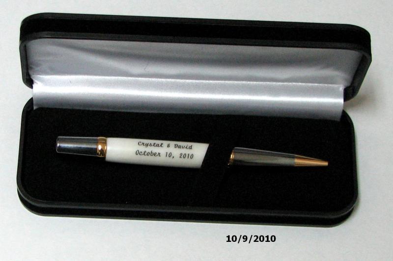

I did this one for our nephew's wedding last October. It's a Sierra Elegant Beauty in gold and black platinum with a white blank. The tube was painted white and attached to the blank with thick CA. I tried using epoxy to attach the tube to the blank but that resulted in a slight brown discoloration on parts of the blank. The writing is a clear label that was attached to the blank after turning and then covered with a clear coat of rattle can lacquer, 4 coats of thin CA and 8 coats of med CA. I used lacquer to ensure that the ink on the label did not run. It was then mm'd to 12,000 and polished with Hut's polish. Everyone, including the Minister could not say enough about the choice of style of the pen.

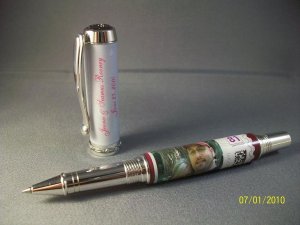

I made this one for my wedding! Its a Jr. Statesman with Rhodium plating. The lower barrel I casted using a Sangria colored label and the stamp from our invitations that were custom made with our picture on it. The upper barrel is also cast in resin with our names and wedding date below it. I thought about a holder for it, but then realized that most people may not even use it and then the pen ends up being set on the guestbook, so what was the point. Your options are endless!
