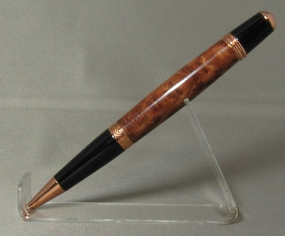

Hi,
I just received my American RBL Studio light box. I am using the two lights that came with it on the sides. I am using a knock-off Ottlight on top and in the front. I am using a Canon A520 camera. This is the picture and I really don't know what to do with it. Neither this photo or any of the others that I posted tonight have the wow factor that I was hoping for. Any advice would be appreciated.
Thanks,
Larry
1. Turn on macro mode by pressing the flower button (you should see the flower icon)
2. Turn flash off
3. Set camera to AP and set f/stop to 8
4. With the lights on, and everything in place except the pen:
a. place a white card/paper in place of the pen
b. go into your cameras setup and pick custom white balance and press set button
c. remove white card/paper and place pen
5. Take picture
I hope I didn't forget anything. [8D]

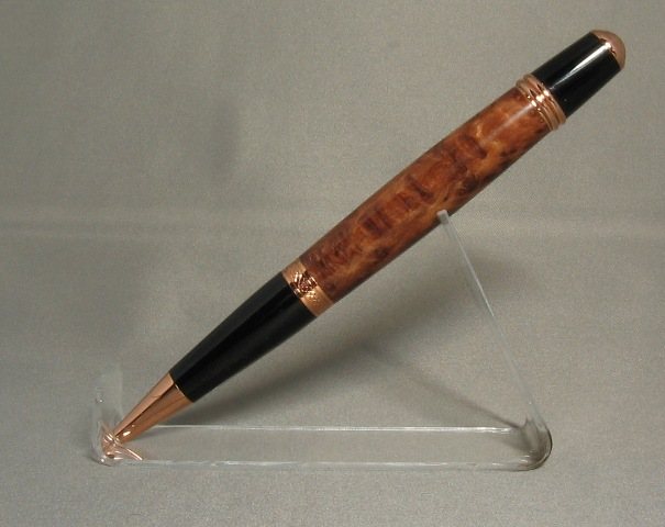

Well, this is what I ended up with after taking Ron's suggestions. I think it looks better that the original picture I posted. I know I need to fuss with the light placement and focus. Hopefully that will come with experience. To tell you what a novice I am, I didn't even know how to set the tripod low enough to get a head-on shot till this morning. gketell, I am going out this afternoon to see if I can find a 18% grey card and then I will try your suggestion. Thanks for all the help so far!!

You still have a bit of a focus problem, and I realized that I did forget a step and this should help:
Set your camera up for a 2 sec timed release. That way you don't accidentally jiggle the camera when you press the shutter button.

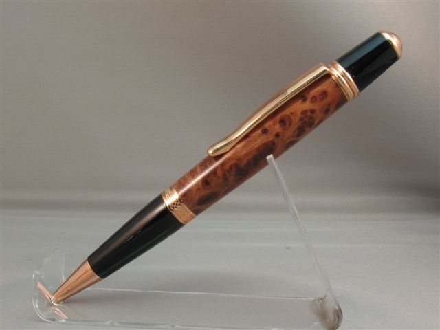

I used the "daylight mode", 3 lights method, and f22 to get
. I needed to back up a bit to get more of the telephoto into the f-stop focus range; it is still a little soft. This was taken on black acrylic for the reflection.

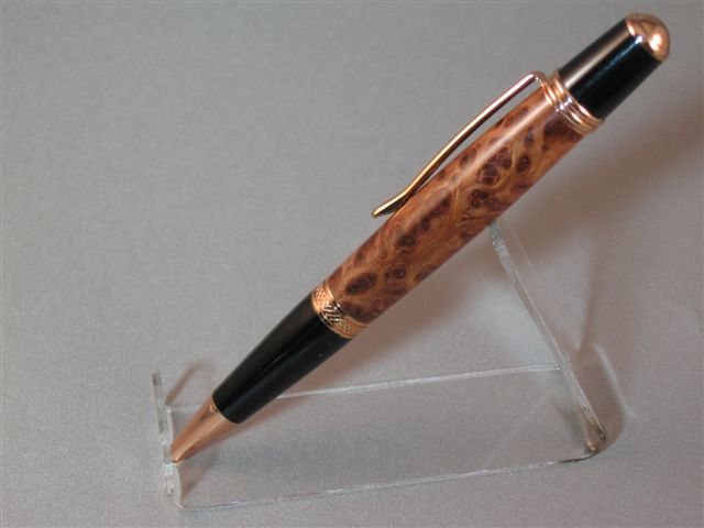

Don't underestimate the power of Adobe Photoshop - in fixing white balance, hue/color, and sharpening photos that are pretty close to begin with. Here is your original picture that you posted after some editing:
