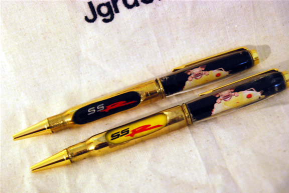

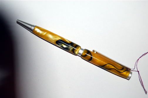

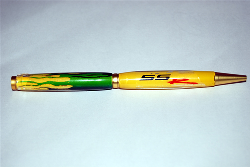

I have been able to do the label process. Resin did not work for me. It chipped, split and allowed air inside.
Correction: the first photo is NOT a label, sorry.
