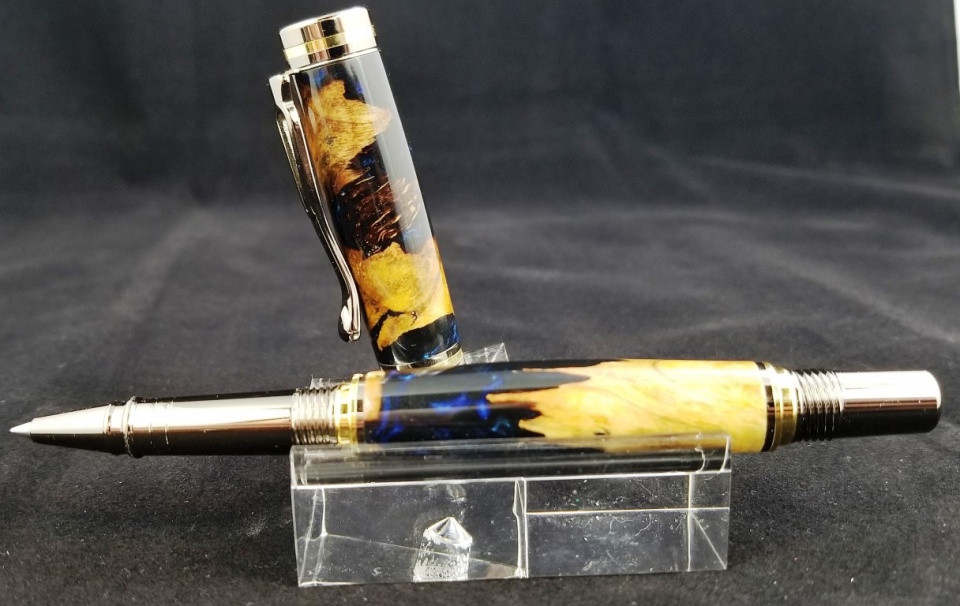

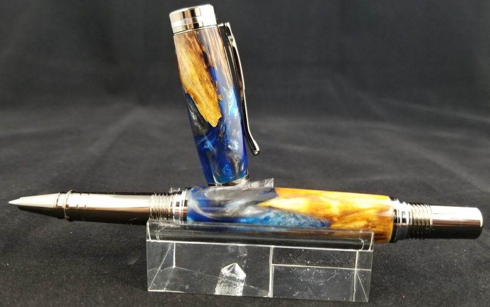

so went with the Kojent from woodcraft because I needed the kits now.
here's the first two. what do you think?

I haven't made that 'Kojent' kit, but I have only bought a handful of kits from Woodcraft when I first started as that's where I got my lathe. Those pens you made are beautiful.
