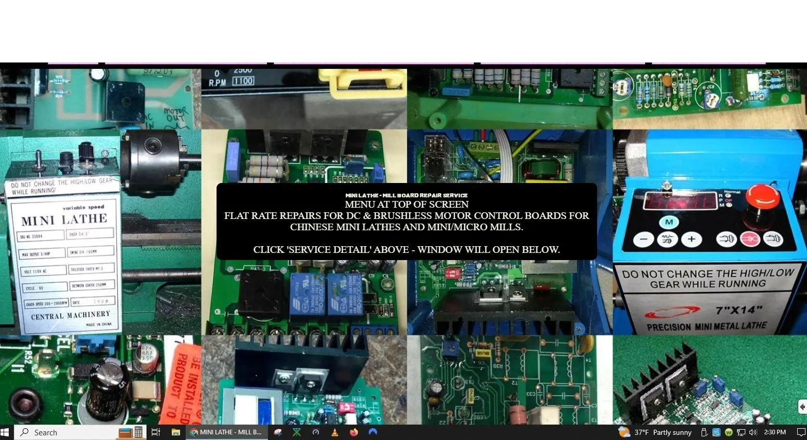

This guy repairs circuit boards for mini mills and lathes. Contact him and see if he will take a crack at fixing it.
I found Peter on another post and contacted him. He fixed it and returned in less than a week. Works great. Thanks for the info. Anyone with a variable speed control should keep the URL you listed above.
