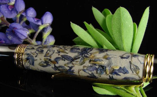

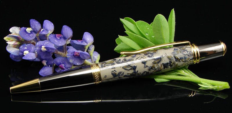

I do not know of any tutorial but I have done a number of flower castings. What I do is dry the flowers in a food dehydrator until they are COMPLETELY dry. I fill my mold with the flowers and then mix up my Alumilite resin and pour it in. Put it in the pressure pot and let it cure. Take it out, drill, paint the inside, and turn like normal.
Here is a Texas Bluebonnet pen I did a while back
Image Insert:
Image Insert:
Curtis,
Gorgeous pen! I have a possibly stupid question: does it matter that the flowers extend to what will be the surface of the pen? Shouldn't they be completely covered by the Alumilite?
Thanks!
David
David,
There are not stupid questions! It does not matter at all that the flowers extend to the surface. They are quite penetrated by the Alumilite. As a precaution, when I get it to the shape I want I drench the surface in thin CA. This will penetrate into any cracks or flowers that are on the surface. I then use a skew as a scraper and smooth it all out, sand, and then apply a CA finish to make sure everything is nice and sealed. Works like a charm!
