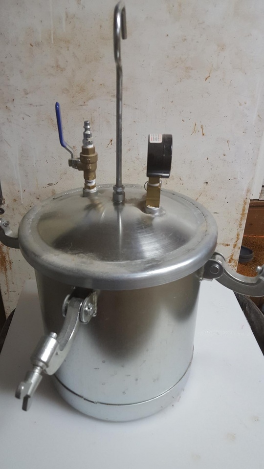

And I am very familiar with the differences. I have 3 Binks pots and 1 Graco, all certified. I used to have 2 HF pots and have set up many for folks. I have also set up 2 of the CA Technologies pots in your photo.
