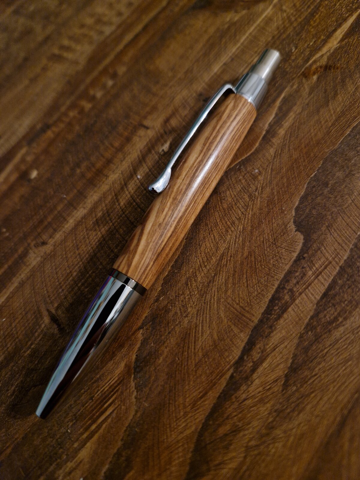

I agree with most points mentioned above . Below its an olive wood pen finished with walnut oil only. I use it to keep notes at home; it hasnt seen abuse but no carefull use either. No dull spots since there is no friction polish to wear. There is a sort of patina forming that is uniform. I wet sand my pens to 1000 maybe 1500 grit but i think that the closed cell structure of olive wood plays the most important role. Again its not super shiny but not dull either. This is the closest to a natural and shiny finish i have achieved.
