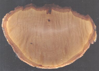

Here is a natural edge hard maple I turned a couple of years ago. I just put it top down on the scanner, sorry about the quality. It's 5 1/2 x 7 1/2 and 3 tall. The wall thickness is 3/32 thick. With the proper arch, the bark will show well at any thickness. Sharpen, sharpen, sharpen! Once you get it to thin, sharpen your gouge and thin it a little more. I've turned these when the bark and the wood is like rubber. As stated, you can cut it proper, but when you get to the bark, cut it towards the bowl.
Originally posted by Tea Clipper
<br />Those are nice looking bowls guys! Are the edges fragile? It looks to me like they would break off easily.. is that true?
They are not fragile. As far as I know these still look the same and thay are still intact and this is more than 2 years old. Ofcourse I am not 100% certain now since these were given away to a family.
That said...the bark is still the weakest part of the bowl so proper care should be taken to minimize any form of impact.
If you are referring while it is being turned...yes, it could be tricky. As mentioned above you can do some things to increase your success rate.
