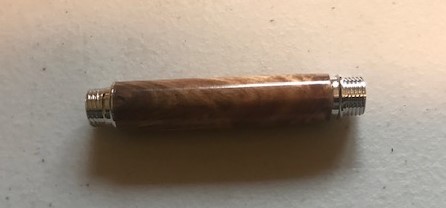

I'm making a Jr. Gent II rollerball and am afraid I reversed the ring. Unfortunately it's pressed in some and I can't remove it. Any suggestions other than being more careful. I can't figure out the thread size on the exposed threads. I was thinking maybe I could screw on something and possibly pull them apart hoping one or the other would come out. If it did I could use transfer punches and remove the offending one if that didn't come out,.
Try putting the end cap on and using a narrow transfer punch. Worked for me the mumblemumble times I've made the same mistake.
edit - unless I've secured the end with CA. The one time that happened I scored a Pyrrhic victory at best. Got the ring off... destroyed the tube and end cap
I too would screw on the cap or nib whichever that end is and just use a transfer punch like normal. If not pressed in all the way it should pop out easily. I have found myself triple checking those rings for some unknown reason. :confused:
Been there, done that. The last time it occurred to me to put the cap on and use a smaller punch only after I had ruined a good pen and blank. Hopefully it wont happen again, but at my age it's not guaranteed.

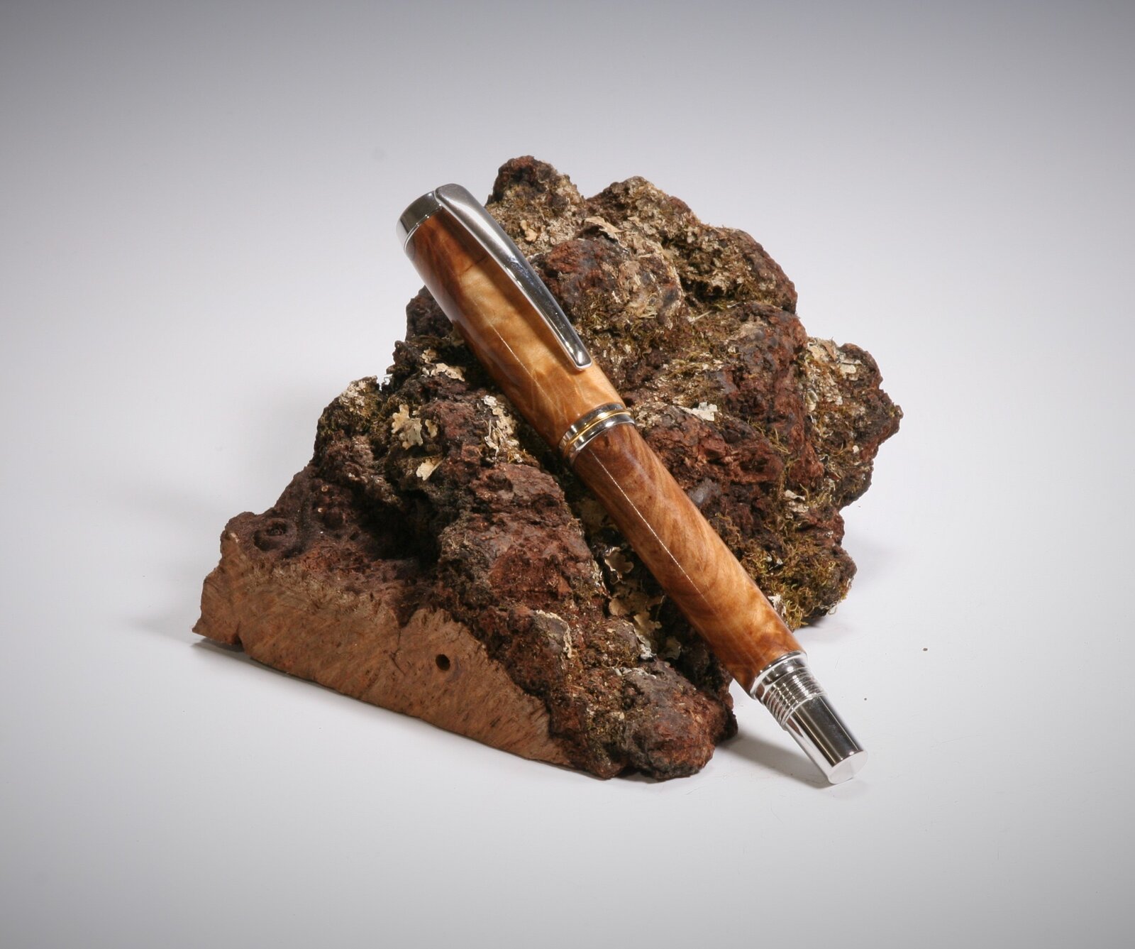

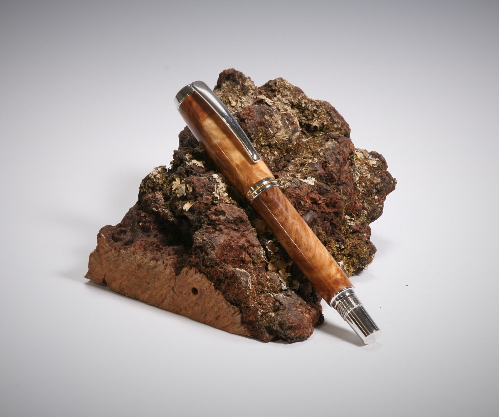

Thank you one and all. I used David's suggestion and got it out. Here's the finished product: Junior Gent II rhodium rollerball dressed in a burr oak burl. GluBoost finish.
