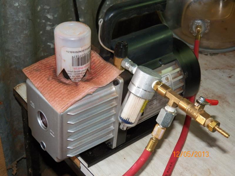

I will explain about preventing the oil mist next, as I have already posted my solution from my older pump that is the same as the one I have now only the top vent which is also the oil filling cap are different and the correct solution so, a pic of the pump you have with a close-up to the vent cap would be appreciated.
I believe that you should start by removing the old oil and rinse the oil sump with some petrol, the procedure is simple. Remove all the old oil from the bleeding screw (bottom), re-insert the screw and pour about a small cup of petrol into the top oil cap/vent, put the cap back and give the whole pump a good shake, this will clean all the surfaces of the oil sump. You have two options here, you either simply drain the petrol immediately after the shake using the bottom drain screw or and I do this every so often, plug the pump to power and turn it on for no longer than 10 seconds before you drain the petrol out. This can be useful to clean the pump internals if oil was contaminated with CJ. I like to use the air blow gun to push any petrol left still on the sump before I put the new oil in.

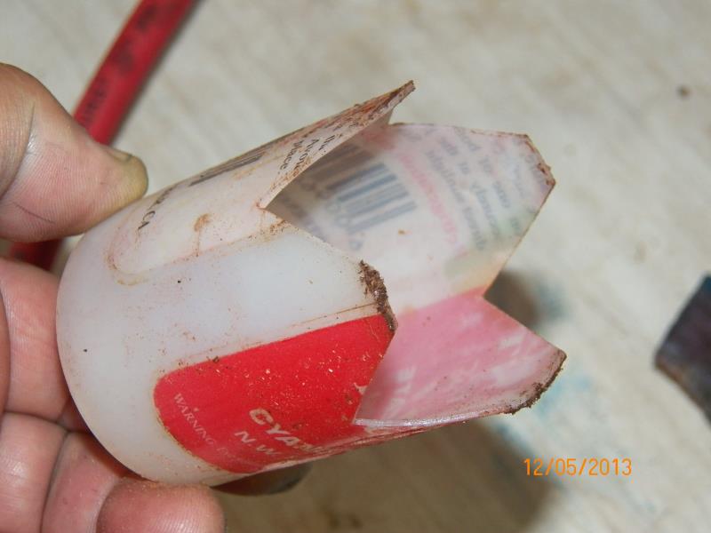

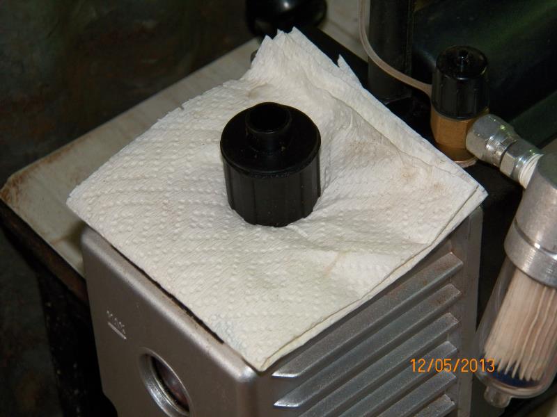

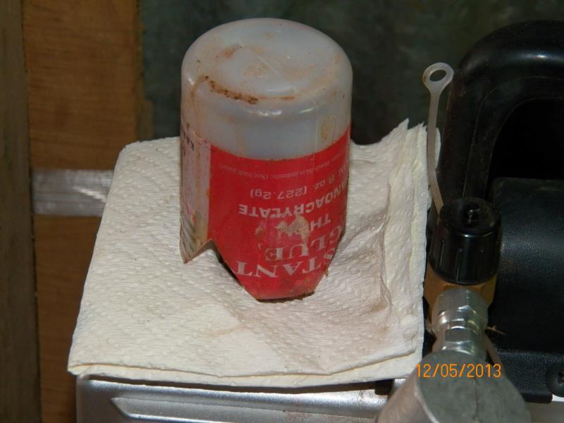

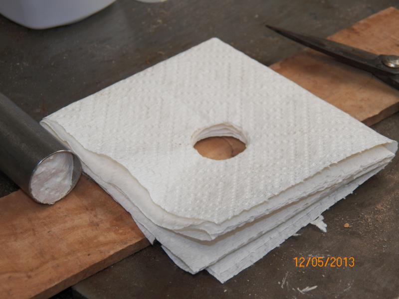

If you do this, you are eliminating one of the main mist causes, the simple and inexpensive way to control the oil mist is shown in the following pics,
remember that this system is for the type of oil cap with the shape you can see, there is a new type now used on moist pumps and those caps the solution is even simpler, you only need the papper tower folded and cut as shown and screw the new type cap right on it, the way it works is that, the mist comes from the inside the black cap and then its the flat top surface where the vertical vents the new caps have, push the mist down but with the paper tower in there, the mist turn liquid when hits the top of the vent and then drips down into the paper towel, when it gets too soaked, replace it.
View attachment 170997View attachment 170998View attachment 170999View attachment 171000View attachment 171001
