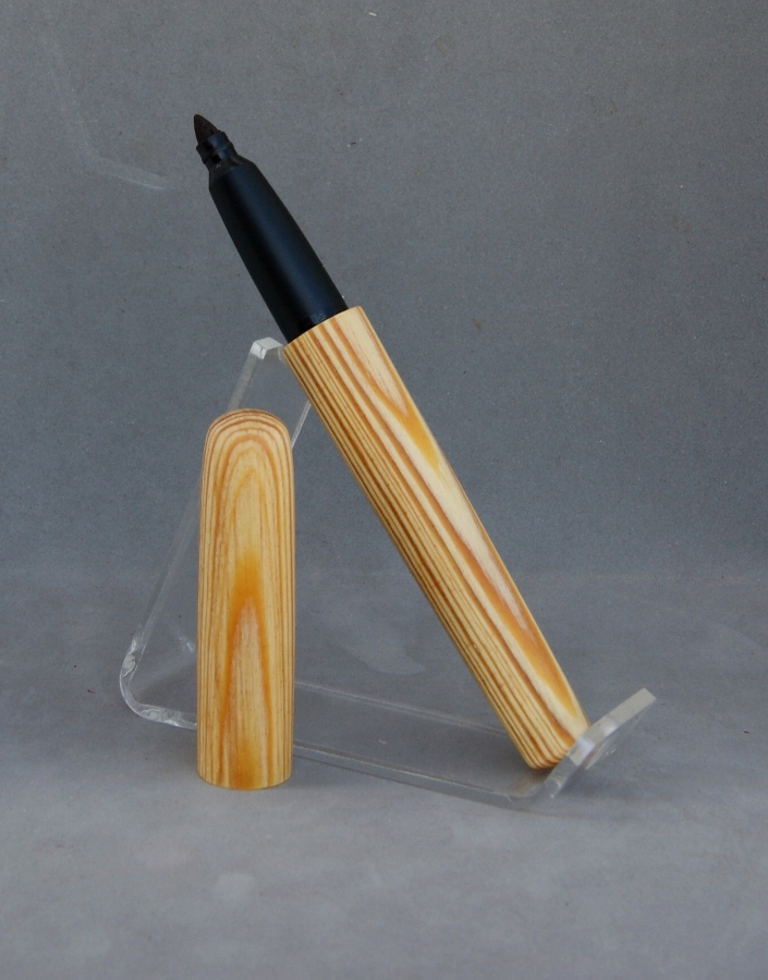

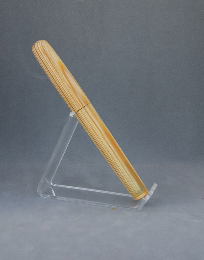

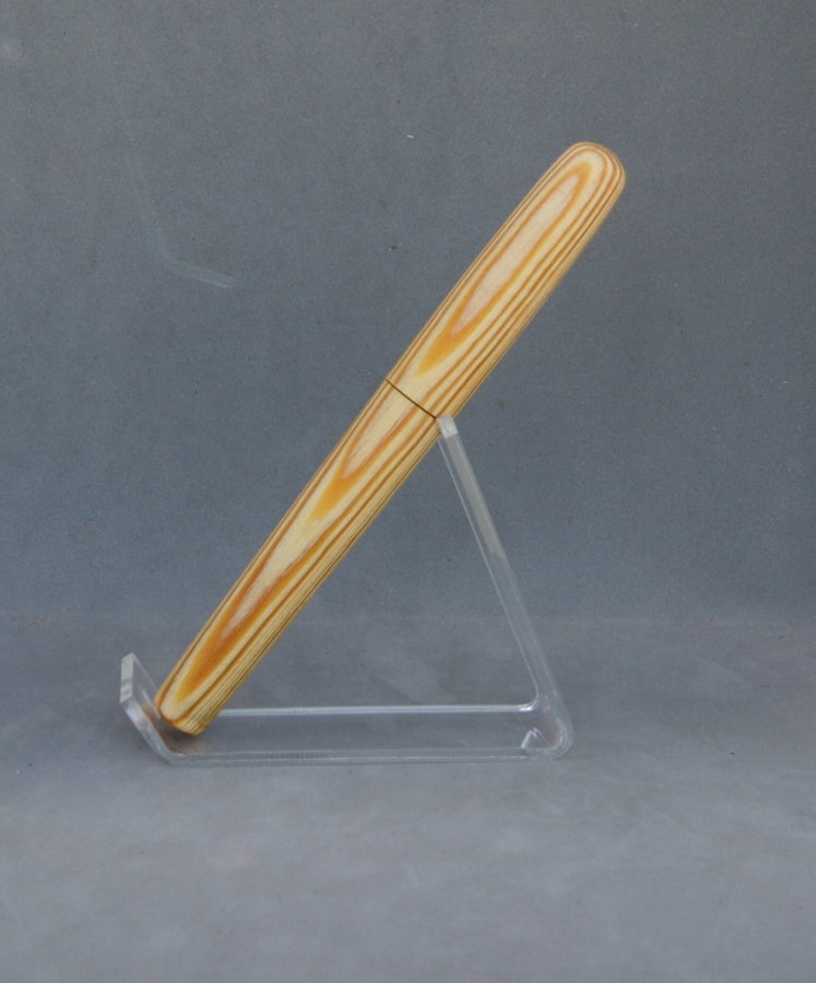

Here's what I ended up making Jim for the Dec. PITH. This was a particularly special PITH bc it was in honor of our friend Landon Smith (Hunter-27). With the theme being Construction bc who can forget Landon's PINE Pith! So I decided to do a nod to Landon and make my first Sharpie out of....you guessed it...PINE! Making this was very nostalgic for me because it also reminded me of my time with my Grandfather. When I was a little kid I would spend every single weekend with him. We'd spend most of our time his woodshop and I'd be his helper. That shop always smelled like fresh cut pine. My Grandfather is also the reason I looked into woodworking 5 years ago and how I got into pens.
By some miracle I was able to turn this fairly thin and even thread it! It's also a snap cap so there's no risk of breaking external threads. I wanted to keep the aromatics of the pine in tact so I didn't use a CA finish. Instead I applied a couple of coats of Tru-Oil to the inside and the outside for protection and strength.

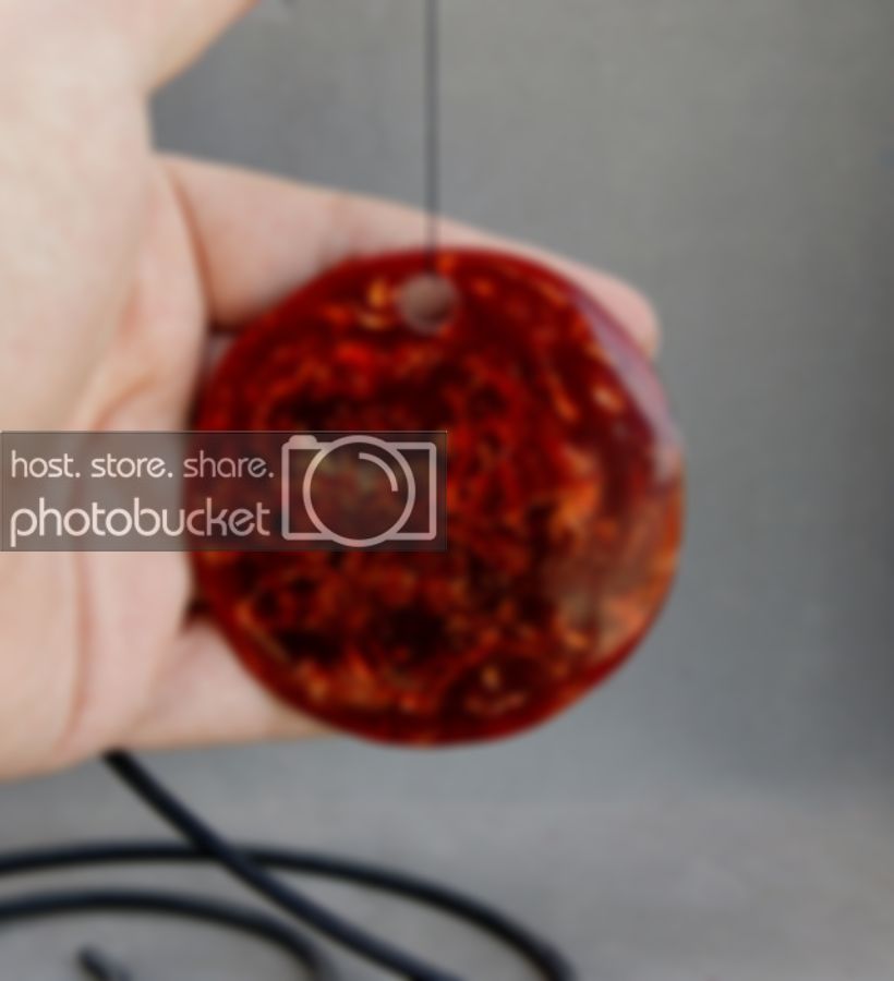

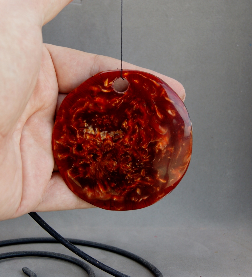

Now on top of doing a pen PITH we also had to make and send a Christmas ornament. Since I didn't cast anything for the pen I wanted to cast something for the ornament (I gotta have resin in there somewhere!). My plan was to use my scroll chuck and turn it on the lathe, but when the time came my scroll chuck decided it want to work so I had to do it all by hand. I did the rough shape on my disc sander (and you can still see that it's not perfectly circular :redface:) and then finished it by hand. The work was rewarding and in the end I was happy with the end result. Thankfully Jim agrees with that! :biggrin:

I was intrigued with the grain pattern on the pine.
At first it looked like a capped end but then the next photo says, no way!
Also, the ornament looks like something blew up inside.
Great job, you done on that pen...!

That pendant cast reminds me of a chilly sauce my mum used to make...!:) very nice.:wink:

Beautiful work,love how the grains match up so perfectly!

Beautiful pen Jonathon from a plain piece of pine . Never would have thought it would be possible to thread it though . Hope the snap cap doesnt put too much stress on the wood and cause the cap to split .
Thanks Wayne! Only time will tell on how well it holds up. Especially if it's well used. The snap cap part shouldn't put any pressure at all on the cap itself. On the refill there's a tiny cap that I drilled a small hole for and glued it in place. Plus when you close the pen there's no contact between the cap and body itself. There's a little cushion of air that pushes back when you go to cap it. So that helps relieve the force. As for threading it, I cheated a little bit. I over drilled for the tap so it would only leave a very shallow channel. I then filled those channels with epoxy and built up a thin layer. After it cured for a day I chased the threads to make them full depth. To test them out I used the refill itself as a make shift mandrel and turned the body like that. They held tight so I'm not worried about them.

Thanks Steve! Luckily since there are no threads in the cap you can spin it around while capped to line up the grain every time :wink::biggrin:

That sure doesn't look like HD pine. That is beautiful! Great job on the snap cap.
