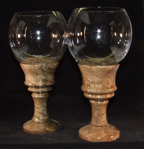

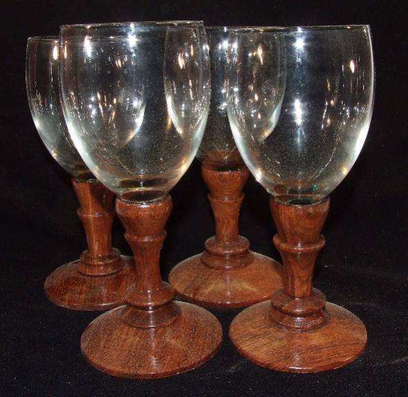

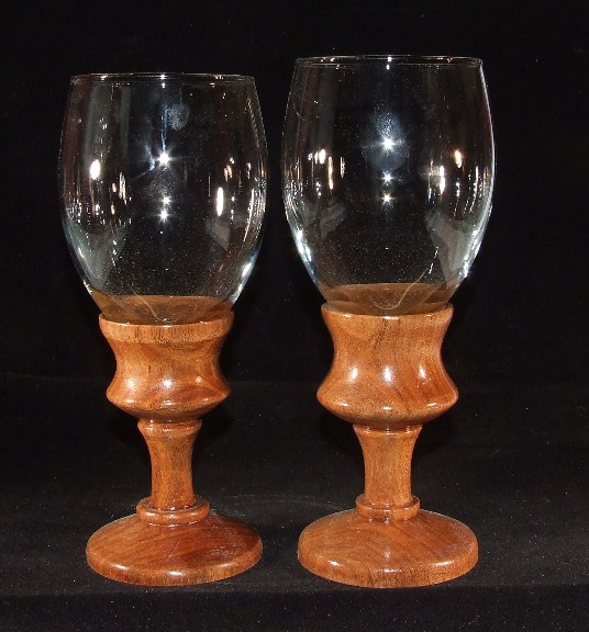

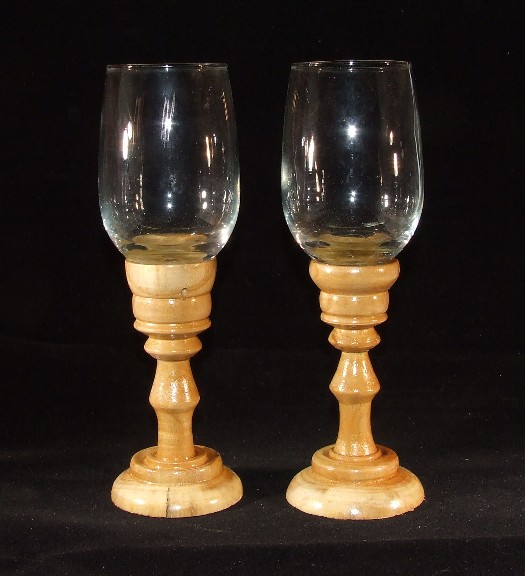

I showed these off on another forum, hopefully my friends here will enjoy seeing them as well.
I like to take glasses that I find in thrift stores, cut the base off and then put wood stems on them.
These are some I've done recently.

Wow that is really cool! How do you attach the glass to the wood stem? How do you cut the glass?
Jamie
Hi Jamie,
I use a 5 minute epoxy to attache the glass... CSUSA sells a glue on the same page as their wine glass globes, but I didn't like that it stays flexible and a good hard twist can take the glass off the stem... the epoxy doesn't seem to do that.
I don't use the globes CSUSA sells... too $$$... I can pick up the glasses at the local thrift stores for usually under $1 per glass... just watch that they aren't stained or scratched.
I cut the stems with a dremel tool with a cut off disc.. about 3 seconds touching the stem will heat the glass enough that it will just snap off... then if you need to (I rarely do) you can smooth the break on a belt sander (carefully... so as not to break the glass in your hand)

Do you cut the entire stem off, up to the globe? Or, do you leave a stub of a stem as a tenon in the turning?

Thanks for the info. What kind of finish do you put on them? I will have to add these to my every growing list of things to turn. Now that I think about it, I think someone gave me a set of wine glasses a few years ago. I have never used them so they might be the perfect canidates for this project.

I leave a little stub of the stem to act as the tenon... I tried to cut one close once and wound up cutting a hole in the glass...

I use different finishes, but mostly I use a wipe on poly because of the handling... I've also used a spray lacquer and a butcher block... the poly works best though.
