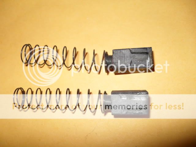

ok backed out those skrews and they were spring loaded. bt they have little rectangular blocks attached. are those brushes? they carry that smell but the whole motor could at this point.
what are they supposed to look like?
The blocks should be of a good size like this
and not worn down to nubs. That being said, I'd agree with Gary and Dozer. HF variable speed products are notorious for blowing capacitors. I wouldn't recommend you try to fix it though as you can get a large charge. You should be able to order a replacement controller board from HF for 50 bucks or so.

thank you all for your help. these are my brushes, they don't look very good, one is considerably shorter and neither have any curvature on the ends, is this normal?
Can you take a picture of them sideways? It depends on how the brushes sit against the armature. I personally think they look fine.

Again, not an expert. I don't think it is normal but I don't think it is a problem. You may try sand them flat and see if it works. Also if you get a lathe without VS you can get a separate VS switch.

Did you not see the pics Daniel? The brushes he posted look fine to me.
Zander, Just went back and read the rest of the thread. I looked at your photos of the brushes and they are fine. so now we can work on the one percent that is left. Uneven wear on the brushes is not unusual. it does mean one will wear out before the other eventually.
As others have already said look down in the hole the brushes came out of and see if the copper plates in there are clean and look like brass or copper. if they look black you could be loosing contact between these plates and the brushes. if they are dirty you can clean them up with a pencil eraser. The brushes are graphite which is the same thing as pencil lead. while turning the UNPLUGGED motor by hand. just stick the eraser end of a pencil in the hole and turn the motor.
I woudl also suspect the VS Control but that does not come into play in my everyday repairs as none of our equipment has those. any black powder you see on your brushes is normal. that is what is left of the brushes as they wear away but a build up on the armature is a potential problem.
Yeah I did.... eventually :) Still the smell issue tells me there is a problem with the brushes or at least brush contact. of course a smell is a bit broad since a cooked component on a circuit board will have an odor as well.

By the way, it should not be so but we are talking a HF lathe. but that shorter brush may be just at the point of loosing contact. when you put it back in make sure you are getting a bit of resistance from the spring. this insures that the brush is actually pushing against the armature. if there is no resistance the brush may just barely coming up short of touching. loss of contact with just one brush will bring the motor to a complete stop.
