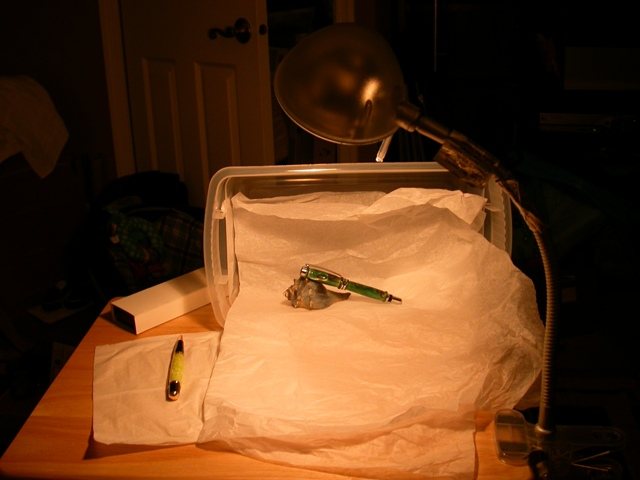

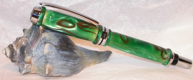

In the Pen Photos for Sale or Use thread, I posted a picture of my "photo booth" and one of the photos I've taken using it, which I've reproduced below. Jaywood1207 asked about the lighting in the pictures, and I had originally responded in that thread, but realized that I was hijacking it to a certain extent, so I thought I'd move the response here:

With your picture I have a question. In the picture of the booth it looks really orangey but the pic of the pen turned out great. Do you use your flash when taking the pen because it is a lot whiter or is the colour in the pic of the booth just skewed?
The ambient light in that room was pretty bad when that photo was taken. We have a floor lamp with a Tiffany-style glass shade, and the predominant color in the shade is an off-white/yellow, so the whole room gets a slight yellowish tint.
I usually shoot a couple pics per pen. One with just the little clip-on table lamp (sometimes I add a second one) and any background lighting, one with my flash set to "fill-in" mode, and one with the flash on. Then I pick my favorite. I also use the white balance setting in my photo editing software (Microsoft's Digital Image Pro) to correct any color problems that may linger afterward.
Oh, and one final note...I have a little portable tripod (less than $10) that connects to the bottom of the camera, and shoot just about all of my individual pen pics with the camera on the tripod, and with the tripod resting on a stable surface (i.e., something other than me!).

It's a halogen, and it came with the lamp. It's not incredibly bright, but it does give some nice extra lighting to soften the shadows.

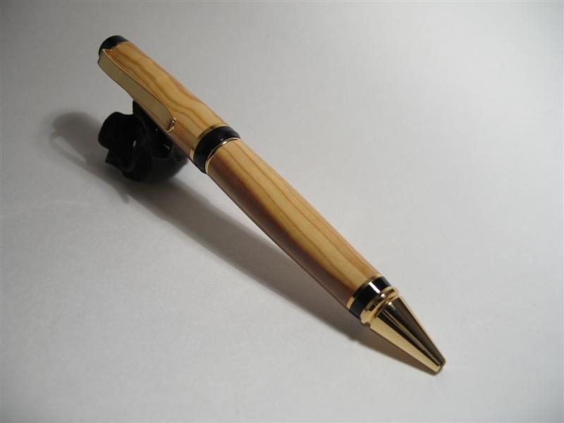

Well here is a picture I took of my first Olive tonight. Decided to use the Canon SD550, used a desk lamp with halogen light in front but still came out dark. The macro setting was used, 2 second timer b/c no flash.
<br />
Next time, resize the image...should be about 640 pixels wide to make most people happy. At its current size, it's too big to see well. I'm competent with a camera, but I don't know all of my camera's settings yet. If you're good with the camera's settings, shooting on an angle like you did, but tweaking some of the other settings, will allow you to get a picture with a nice depth of field. However, if you're not careful, you'll have focus problems like you can see near the tip on your pen. If you switch the orientation so it's all in a single plane that is perpendicular to the camera, then everything should be nicely in focus.
