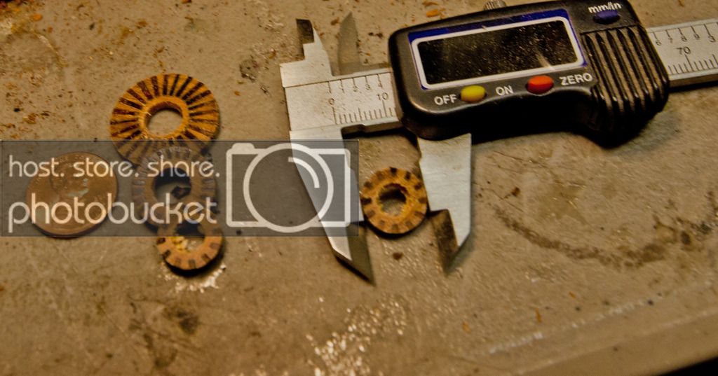

I don't want to give away too much information about my pen yet, but I thought I would show a photo of one of the seams after it's glued and turned back down to see the seam. This is what is taking me so long. Is the seam acceptable enough to continue? Remember: I have no camera skills = bad photo.

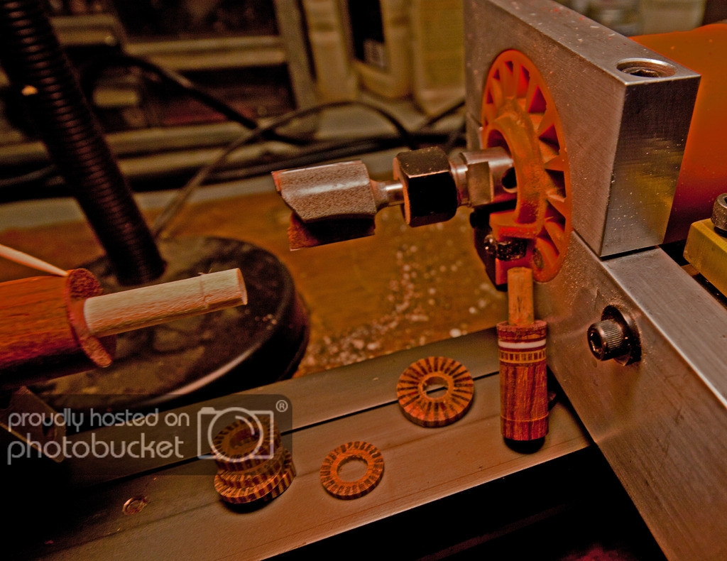

Doesn't have to be that way.
Could you give some details? It looks like you use a dowel cutter. Are you using it as a mandrel or as a form for your segmented rings? Also it appears your using a rotary cutter to cut rings. If so are you using a metal lathe or a X-Y cross slide on your wood lathe?

To your question on time, there is no answer and never will be. many factors go into building a pen blank. But you are creating as opposed to those that just take a plain wood blank or acrylic blank and turn it round. Not much creation there. So take your time and plan your work. As far as the seam shown it is fine. Unless the pen is in someone's hands you really do not know how well the blank was built. If it passes your eye test is what counts.
