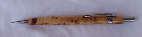

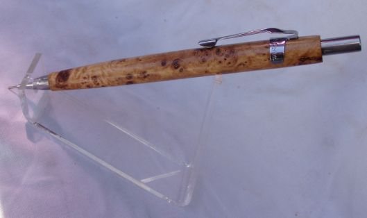

with the new bit, that is. I've never used one but I had seen one in another's shop. He would not part with it. After making many many of them using various methods of drilling, I decided to have some made. The bit does work well as others have mentioned. The wood is nothing spectacular: mesquite from the pasture next to my house. Just thought I'd share.
Do a good turn daily!
Don
NICE! I bought one of the bits but haven't used it yet. I know it's in the tutorials but I couldn't find the answe to this question: Do you use a brass tube inside the wood and, if so, what size?
Hi Julia,
Sometimes I use a 7mm pin chuck and when I do I glue in a 7mm tube in the correct place to accommodate my pin chuck. The hole must be reamed larger with a 7mm bit. But, the tube needs to be pushed in about 1 inch from the top. The chrome eraser cover will not fit inside the tube. Also, care must be taken to not get glue inside the hole and restrict the insertion of the mechanism. I'm considering the 7mm expanding mandrel for close end pens that is sold at Arizona Silhouette. This pencil was turned between centers using a home made morse taper in the headstock(like I show in my tutorial) with a small tenon to fit inside the small hole. My 60 degree live center was snugged into the larger hole on the other end. I use several ways to hold the blank and I've not decided which I like best. Maybe some clever ways to make this pencil will be shared by others. I'm sure my methods are not the only ones.
Don
