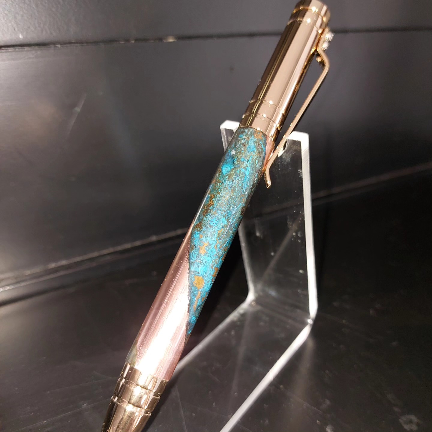

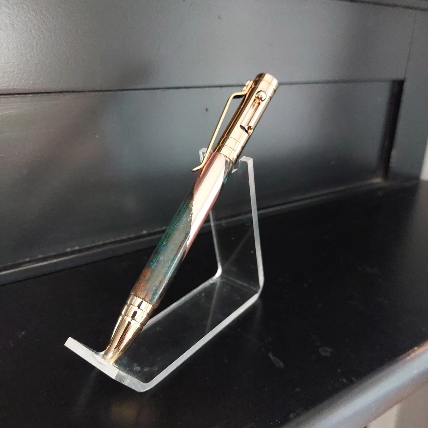

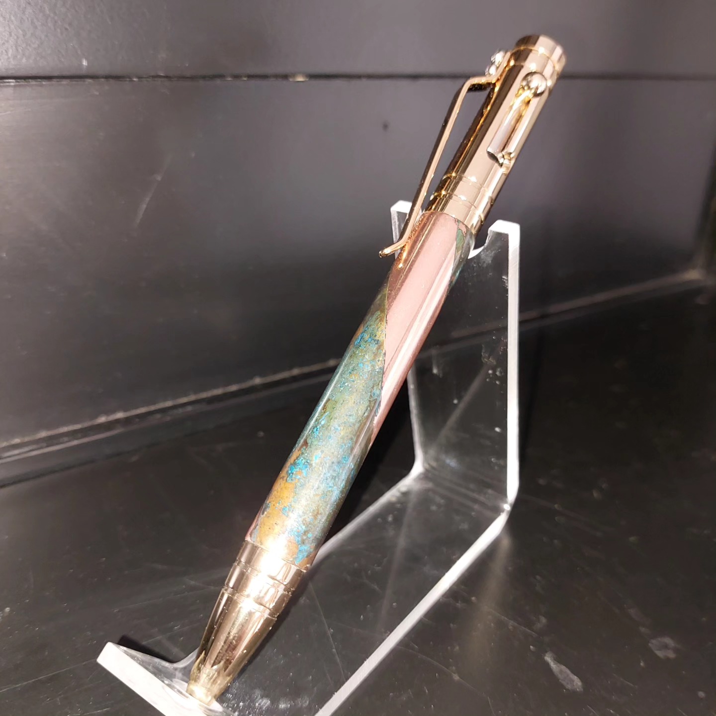

It's been a long time since I turned anything. I had to take apart my workshop last fall cause we were changing from an oil furnace to propane and then just as I was getting organized to start turning again, we broke a water pipe and I had to enter the Year of Reno Hell. I've had some extended time off this fall from work and was able to get set up again. This is the first pen I've turned since the spring of 2022. The barrel is brass which is then copper electroplated and patinaed. I basically had to relearn my whole process again, but I am pleased with the results. I use a clear gloss spray lacquer to fix the patina sections before finishing with CA. Moving forward, I'd like to get away from using CA to finish, mainly cause I don't want to develop any sensitivities to it. I would like to find a way to use clear epoxy if I can find a method that isn't as wasteful.
