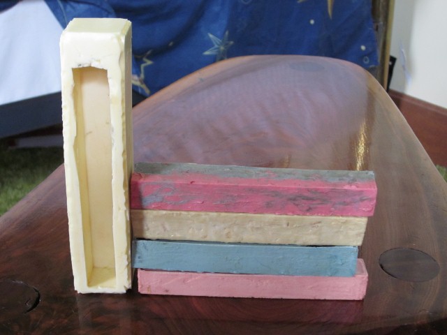

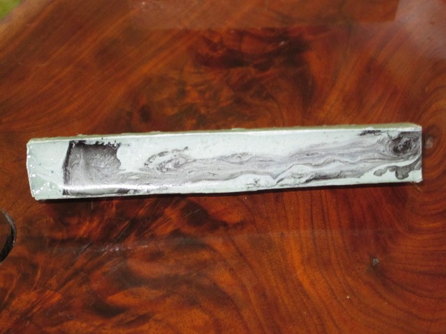

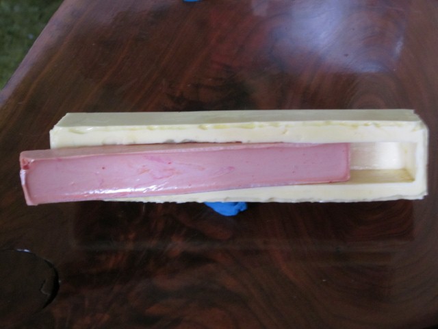

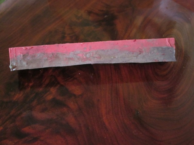

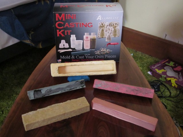

Well, yesterday I bought the Aluminite mini casting kit, built a mold box out of 0.040 styrene, mixed the silicone and poured it. This morning I removed the mold and cast some blanks. 1 is a solid red/pink, one is a mint green metallic with some black swirling, the 3rd is oats cast in uncolored resin and finally a black/red swirl. Some notes on this kit: The amount of silicone is perfect for a 1.25x1.25x6 mold box with a .75x.75x5 cavity. The aluminite kicks fast and sets in less than 10 minutes. The resin sets to a tan color. It was extremely easy, I hot glued the mold box together and glued a piece of wood in the bottom. Here are the pics.
