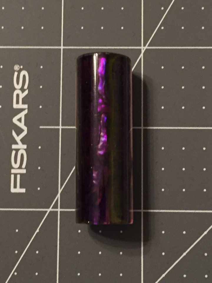

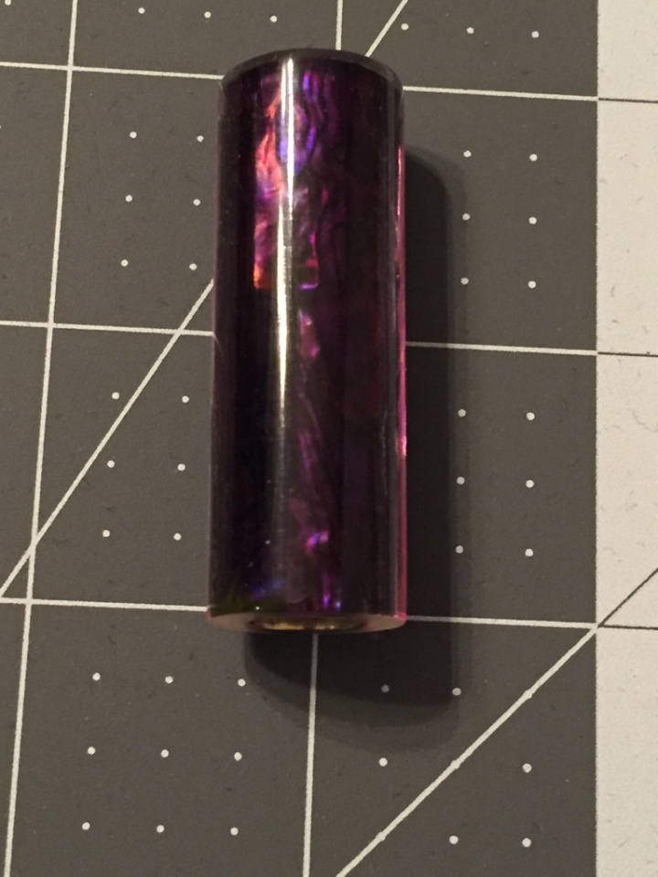

My first casting was Abalone Shell with a purple tint using Liquid Diamonds. 50 psi for 24 hours. The cast is bubble free! The cast is hard and turns beautifully! So far so good.

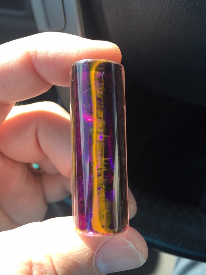

Now for the step back. I used a purple Sharpie to color the edge of the Abalone Shell and the Brass tube at the single seam. The Sharpie bleed into the LD resin leaving and orange stripe in what would have been a great blank.
Time to do some testing with different paints and LD to make sure they are compatible before casting anything else especially some watch part blanks that are in the works.
DON'T USE Sharpies with Liquid Diamond Epoxy!!!
