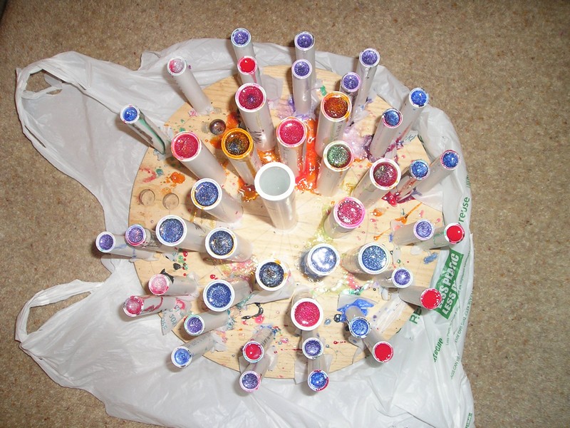

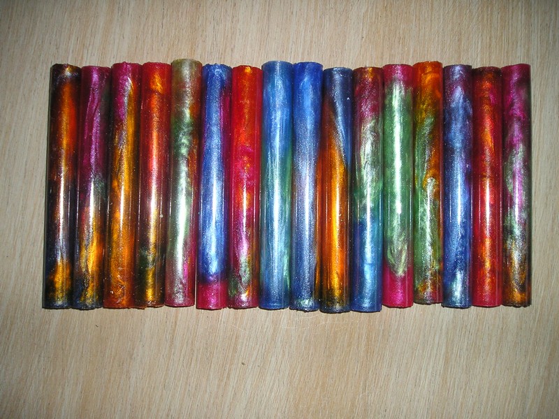

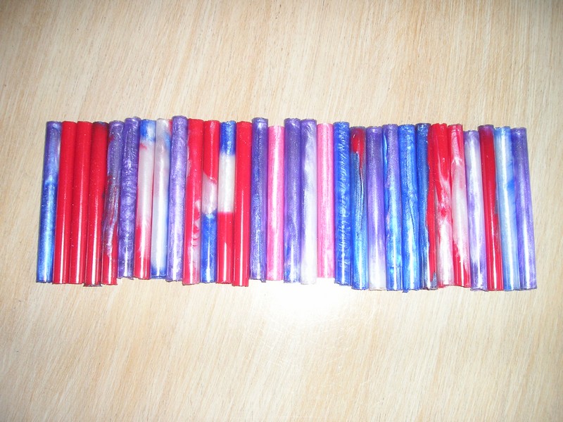

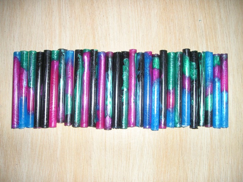

I finally got round to having a go at casting some PR blanks. I am quite happy with the results so far but have yet to turn any so I will not get too excited.
First pic is 28 blanks at 1/2" dia "Slimline" blanks, no waste apart from drilling, 4 3/8" in length.

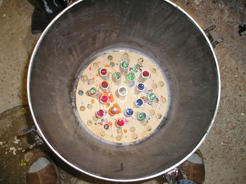

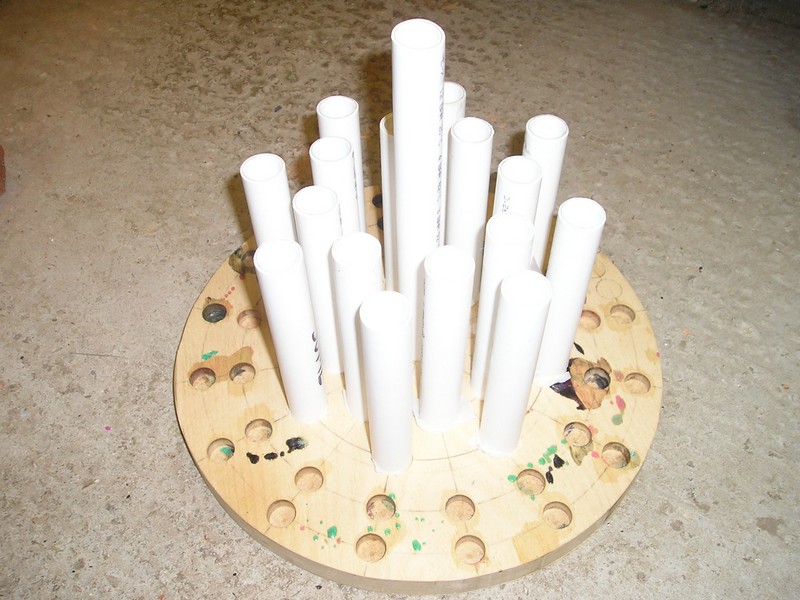

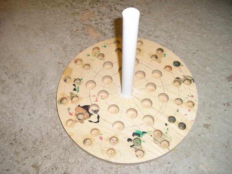

Second and Third is my mold rack. Just drilled holes into a piece of MDF with a 15mm forstner bit and the tubes stand happily in there. I did 32 at 15mm and 16 at 22mm for the larger blanks.
Fourth is the rack in the pressure pot.
Fifth is after the second pour with a total of 44 blanks.
The plastic pipe is plumbers "push fit" and the PR just slides right out when cured. No residue is left so the tubes are ready to go. I use a small sqaure of polythene in the hole to stop the PR sticking to the MDF.
I hope you like them.
Eric...

Pretty nifty setup. I assume the middle one is the handle so you can lower it into the pot? Do you use a funnel to pour into the tube?
Skiprat you are correct in that the middle tube is the handle. I don't use a funnel, just a steady-ish hand. Never pour after drinking :)

Hi BSea, I cast 26 of the smaller blanks at once and 16 of the larger. I do a little test by dribbling a little of each color into a small plastic cup and if they don't blend then I just do the pour. The only thing I don't like about the pvc tube is that you can't see what you are getting. I completed another batch last night and the larger ones came out very well, not too sure about the thinner blanks.

Notice you have several colors and they appear to be blended quite well. Do you stir the contents of the tube once you got the tube full? Nice blanks, I've only done 2 colored.
