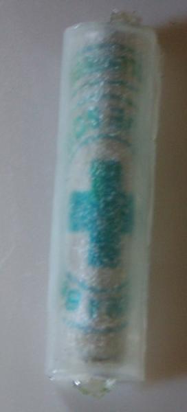

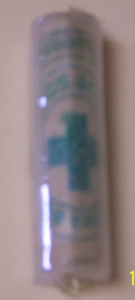

[/ATTACH] I hope this helps. The second picture is better. I couldn't delete the first with out deleting the second.
I is suppose to be a green cross with : Virginia Beach Rescue Squard around it.
