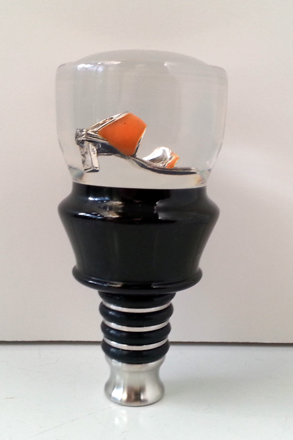

First bottle stopper casting
My first bottle stopper casting with embedded item. Thanks to all for the advice. I'm happy with the way it turned out and looking forward to casting more.
That came out real well. It is another one of those turning projects that has a lot of potential for great ideas. Good luck.
That came out great! Did you degas or use a pressure pot? Zac Higgins on Youtube says you don't need either for PR, but I find there's more of a chance of air bubbles when I don't degas. There's a 25% off sale at HF so I think I'll get a pressure pot since my vacuum pump died. Anyhow, nice job, I've got to try that.
Ultrasonic - no pressure or vacuum
I used a Harbor Freight ultrasonic cleaner with heater pretty much as described by Don Ward a.k.a. "It's Virgil" in his library article Casting Bubble Free. This bottle stopper made me a real believer in the process.
