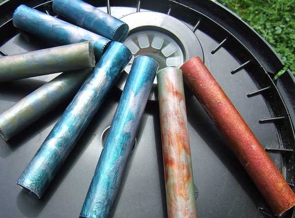

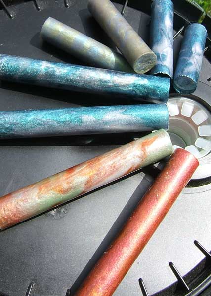

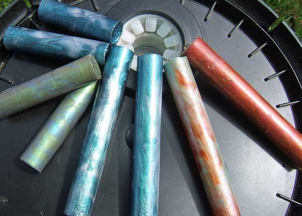

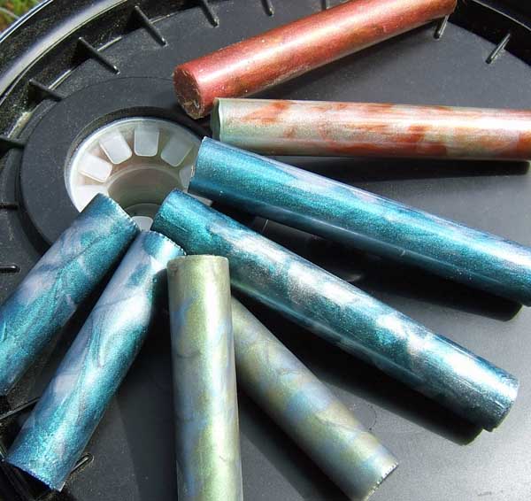

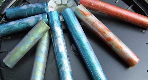

My camera skills are less than my casting skills.
And my casting skills, well....:rolleyes:
Hey, Dan... these are REALLY BAD (GREAT.) Like with anything practice makes us better at something, or not. Really great colors, very artistic, is it PR or AL?
It's Castin' Craft resin.
I never really seem to improve. If I don't get it right away, I don't usually get any better. I just don't get camera's. They never see the same thing that I see.
I like them. How do you get the nice swirls?
It's kind of hard to explain, but...
I pour the one color in, and then hold the mold at an angle and rotate it as I pour the additional color in.
Did you use a pressure pot with this product? The blanks look great. Nice colors. Fay
I did not use a pressure pot. I haven't found a reason to use one, yet. From what I've read, the pressure pot is used to eliminate bubbles, and I haven't noticed any of those.
I let the resin rest before pouring it into the molds. While it is resting, some smaller bubbles come to the surface and disappear. I've also read, that a flame held over the resin will evacuate the bubbles. I haven't tried it since I haven't had any issues.
