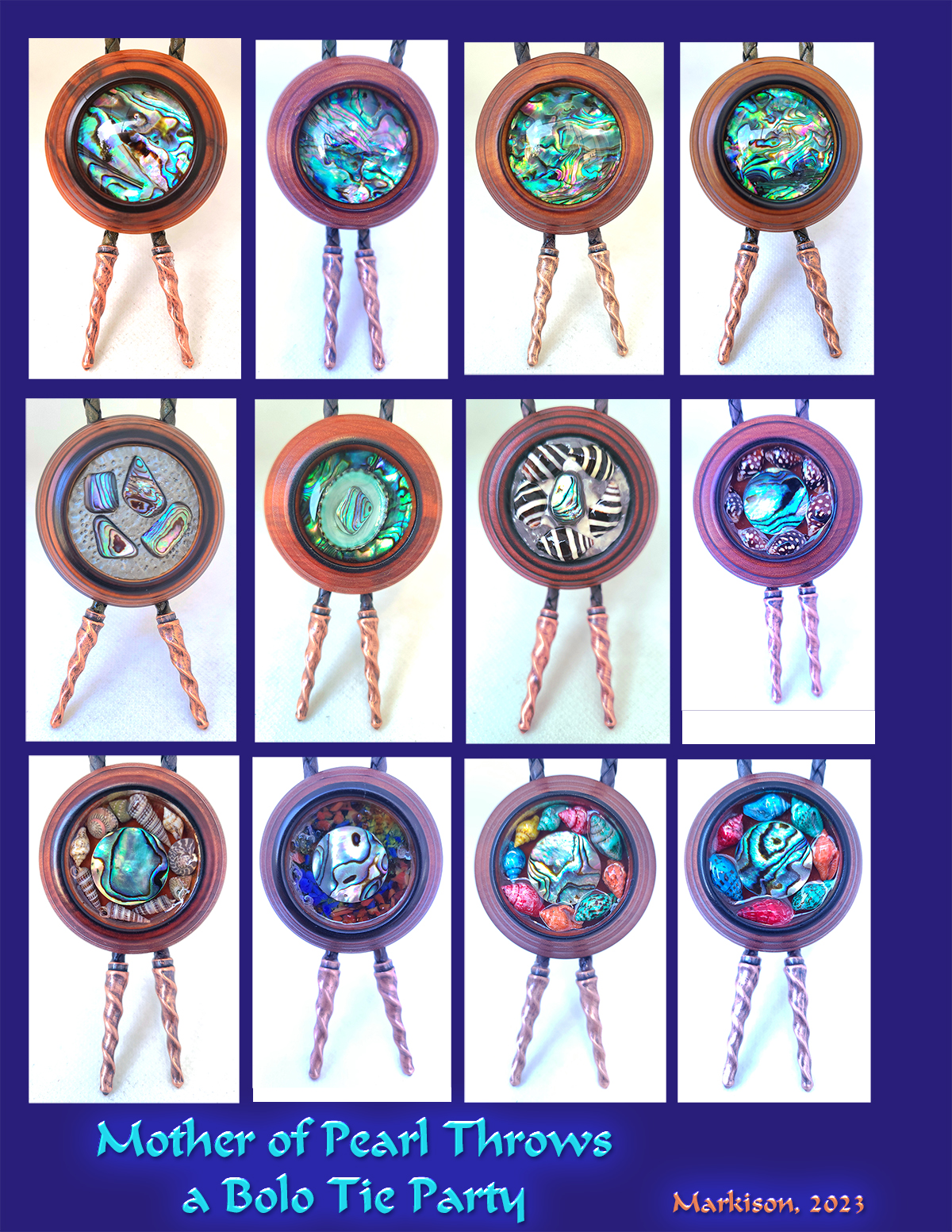

This was fun project to celebrate this remarkable naturally dichroic material. Since Mother (of pearl) is toxic - it's best to work with her outdoors with diamond tools, respirator mask, and 2 fans for ventilation. I lathe-turned Italian olive wood or Brazilian pernambuco for the settings. The tiny shells are from a friend in Florida, and I airbrushed color onto some of them with an Iwata Custom Micron B airbrush. Some of the bolo ties were sealed with UV epoxy resin (triggered with a 365nm wave length lamp).

Those are beautiful! I was curious about the shell material being toxic, so I went looking…. Seems to be a lot of anecdotal reports but little or no actual medical data. Mostly fine dust particles, which your respirator would have been perfect for, but no verified harmful stuff other than that. Unless you have allergies it seems like it'd be safe enough to work with normal precautions.

Jim (RoxnDox) - here's a cautionary tale: It was indeed the fine dust particles that got me in trouble about 20 years ago despite use of a previously helpful respirator mask, and cutting properly cured water-submerged abalone shells with good diamond bits in what seemed like an adequately ventilated shop. My sinus CT scan revealed multiple opaque/blocked sinuses - required a rather extensive fiber-optic sinusotomy. My otolaryngologist friend used local anesthesia only (at my request) so I could watch the monitor with him during the operation. Somewhere between the drilling sounds and his proximity to my optic nerves and command central while he cleared out the catacombs, I decided to go outdoors for any similar work. Have fun and stay safe.
