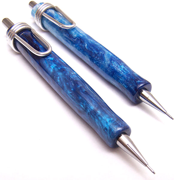

Most comfortable Pentel I've made, but it needs...

A clip!!!!
I'm thinking 1/16" or smaller aluminum rod wrapped around the barrel with a loop hanging down for the clip kinda like the chrome one on my blueberries and cream pencil. Thoughts?
This thing is amazingly comfortable though.

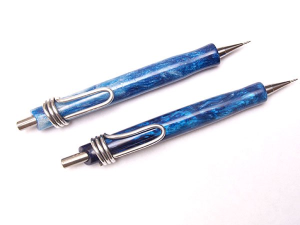

Here's what I settled on for clips. The two pencils are both similar, one is slightly fatter than the other. I was under a deadline (they were already sold, without seeing the clips!) so couldn't embellish further.
5/32" aluminum rod.

Don, I've have been tinking around with clips designs lately, just wondering, is the 3/32 aluminum stout enough for a clip? BTW, like the wrap around you did. Seems to fit the style of pen.
It definitely seems strong enough. It will bend though, instead of spring back, if too much force is applied.
My next ones will use stainless steel wire of about the same diameter. Hopefully to get it a bit stiffer.
