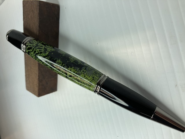

I cast some dried moss in Alumilite and turned out a pen.
What do you think?

This community is a tad more discerning. I'll take critique and suggestion to improve upon this pen.
I think you did a good job on that . To determine the aging effect , if any , you need two more . One in the dark , one in sunlight , and the one in your wifes purse as an uncontrolled control .

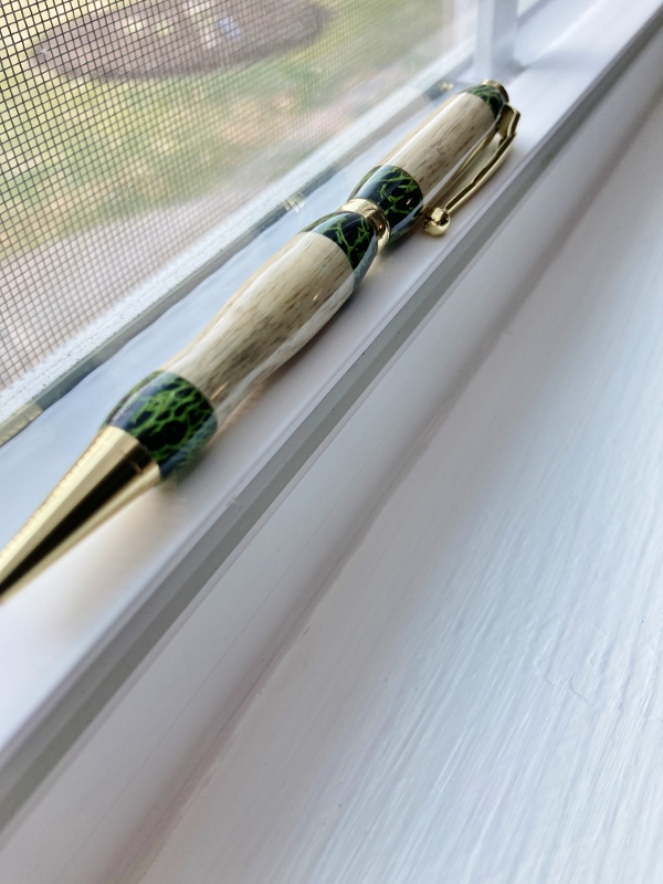

I have more moss blanks. I'll make a second pen and put it in the window and let you know!
Looks good. I dyed some red once and cast for a Dr to look like veins. It eventually pulled away from the resin. I don't think I dried it long enough. I Hope yours holds up, I like the green.
Looks great! It's easy to see why your wife likes it. I wondered about aging, too since it looked so green and fresh. Then you mentioned that you purchased moss rather than grabbing some out of the back yard. I would think that should age well since there shouldn't be any moisture content in it.
Good job. It will be interesting to see how it reac ts to time. Please share that part when you get some age on it and some light.

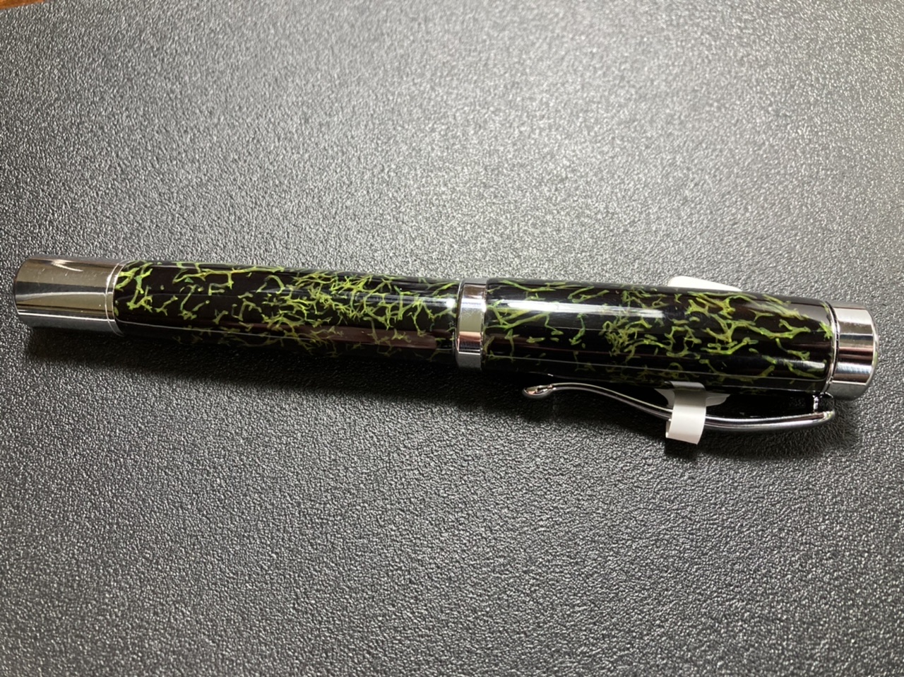

We'll I gave that first pen to a friend and he's still using it at his work. I lost the one on the window sill, which leaves me this last one. It's holding up just fine after 15+ months, and will be going to market at my first craft show in a few weeks.
Imagine my (pleasant) surprise when I learned that this thread was old, and that I don't have to wait 6 months or a year for the results of your aging study!
Sorry I missed your post the first time around - I really like the moss blank, and how the pens turned out, and how they didn't really change that much over the past year.

Awesome! Did you just use clear resin and paint the tube/blank black, or is there dye in there to contrast the moss?
I bought the moss already dried. It's like $18 at Michael's, but was < $5 at Walmart. I used it straight out of the bag, but beware that there's dirt you'll want to pick out with tweezers. I've also since learned to microwave dried goods to evaporate any residual moisture that may foam the resin. I used gray mica powder in the resin, but too little of it, and it basically came out clear. I painted the hole black with spray paint before gluing the tube.
