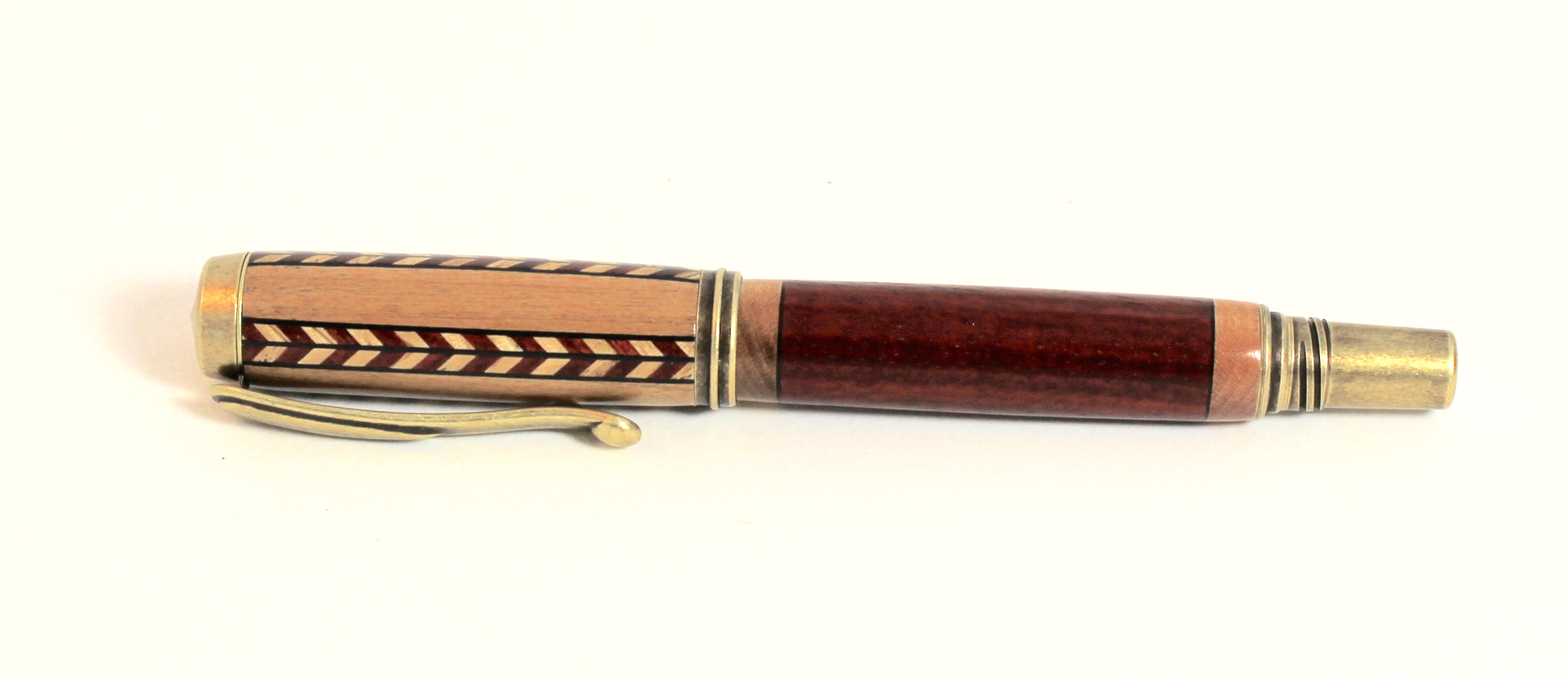

More Chevron Fun!
I probably like this one the best because the elements flow better. It has a theme to it. I like what you are doing with these. Is there a tutorial in the future??? I have to ask because any time I show something that is what I get asked. Or how about photos of the before turned pen??
Serious though how are you cutting the small pieces?? Maybe you can share that part with us. If not all is understood and keep up the great work. Love seeing this kind of work for sure.

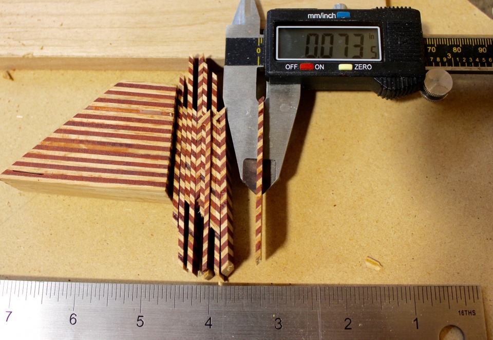

I have submitted a full library article to Wayne on how I (may not be the best way) make the Chevron Blanks. As you easily understand, knowing HOW it's done is only a small part of the challenge - then you have to work out the precision yourself.
I'll transfer some pics in a few minutes.

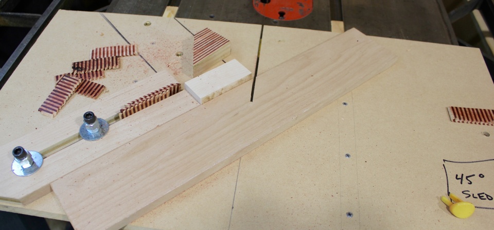

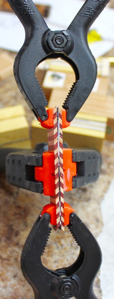

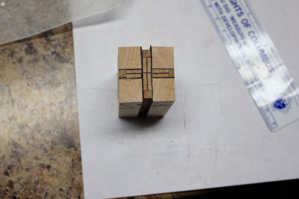

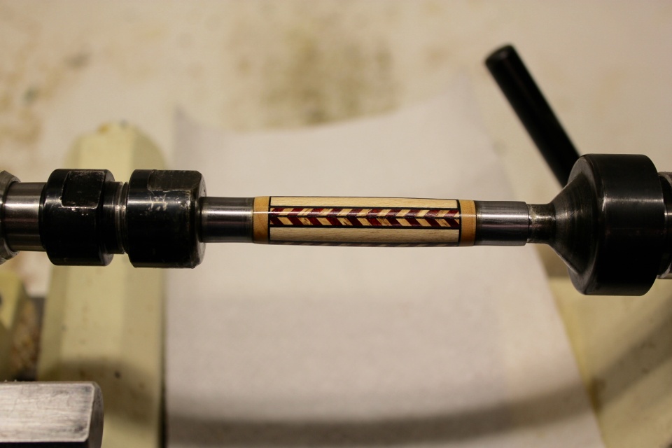

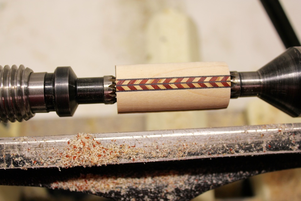

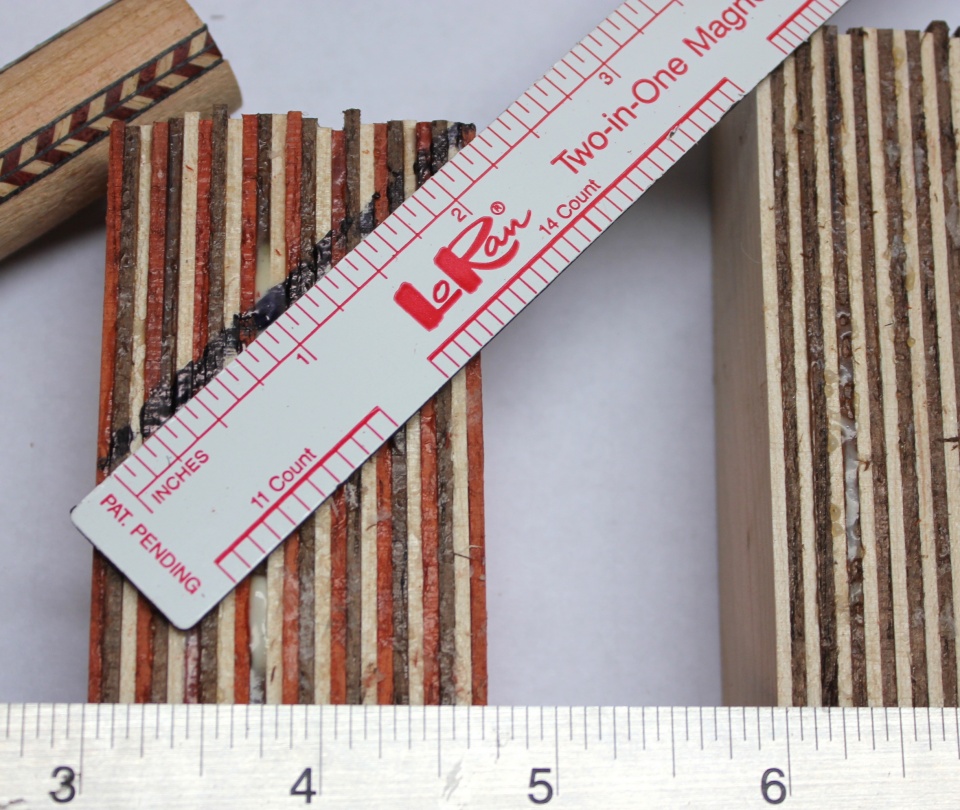

JT asked for some hints...

Man I wish there was a "love" or "wow" button to click on this post!!! Beautiful pen! Reminds me of some of the patterns you see on strip built canoes and kayaks! thanks for the photos! I was able to follow your thought process on how you did this. I wonder if you could take a pre-made spectraply blank and achieve similar results versus gluing up your own? The only reason I say that is I have no clue where to get thin pieces like that and my bandsaw was a $60 estate sale 1984 craftsman that wobbles beyond belief! Even after switching out the tires to the nice urethane ones and balancing the wheels. There is no way I'd be able to resaw such thin pieces.
Mark, thanks for the photos and look forward to see the tutorial. The amount of work that goes into these type segmented blanks is tremendous and yes accuracy is a major key because you are always looking at something to compare each cut with and the eye sometimes sees things that are not there but most times can see mistakes. As mentioned your work on this type segmenting continues to improve. Look forward to see what you come up with next. This kind of work gets my brain thinking.

Lee there is no reason that it can not. The key as you may have picked up in Marks photos is to have a blank glued up long enough that when you make the diagonal cut it is one strip. The spectraply blanks need to be glued together but you need the proper orientation if you get my meaning. Now you can do smaller or shorter segments and they work fine. You can do this with all kinds of medium and the sky is the limit. Maybe we get to see others try this now that Mark has shared some of his secrets.

Lee: As John stated and I agree - keep fiddling with what you have. Truth be told, my band saw and table saw are both entry-level Sears Craftsman from the early 1990's. I do have a Byrnes Thickness Sander and Table Saw, but I used the Craftsman table saw and got these thin slices.

Another fabulous pen, Mark !!!!! . What woods did you use ?
Thank you Mal. Bloodwood and Hard Maple. Be sure to apply a sanding sealer to prevent the bloodwood from staining the maple (and don't use with an open grain wood like oak... DAMHIK).

What type saw blade are you using? Seems like there would be a lot of waste due to the kerf.
Hi Rick:
I have a Home Depot Diablo Thin Kerf blade on the table saw. With my jig (simple to make), I am easily getting .073" slices.
For the blocks I have made - they were 1" H x 1 1/2" W x 6" L. I was getting about 25-26 slices. This is enough for 3 pens, using the way I was making the chevrons. You may get several more slices, but I kind of like my fingers.
I may start gluing up 3/4" H blocks, then I can use my Byrnes Model Maker Table saw which has blade kerfs of .06" (carbide) or .02" regular. This may yield up to 1-2 more pens.

Mark what angle are you making your cuts??? Have you tried doing various angles to change the look???

So far I have just used my 45 degree jig/sled. Other angles are in play, but only 24 hrs in a day... :) (I know you understand). I have 2 more dry blocks to play with, but have been doing a lot of household chores the past 10 days, mowing and weeding, etc... so no new ground (pen turning) was attempted.
A different angle will be fun to see the results. As the angle gets modified, I may need to use the thickness sander to get the strips equal... just thinking off the top of my head - (not usually a good idea)!. But, a great idea. :wink:

If the slice is thicker or thiner, when combined with the other half, the overall thickness may be different, altering the inlay. My results have been good for certain dimensions, so I may need to keep the final Chevron (2 layered slices, 3 veneers) a certain thickness. The thickness sander allows me to adjust the chevrons.
