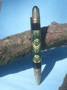

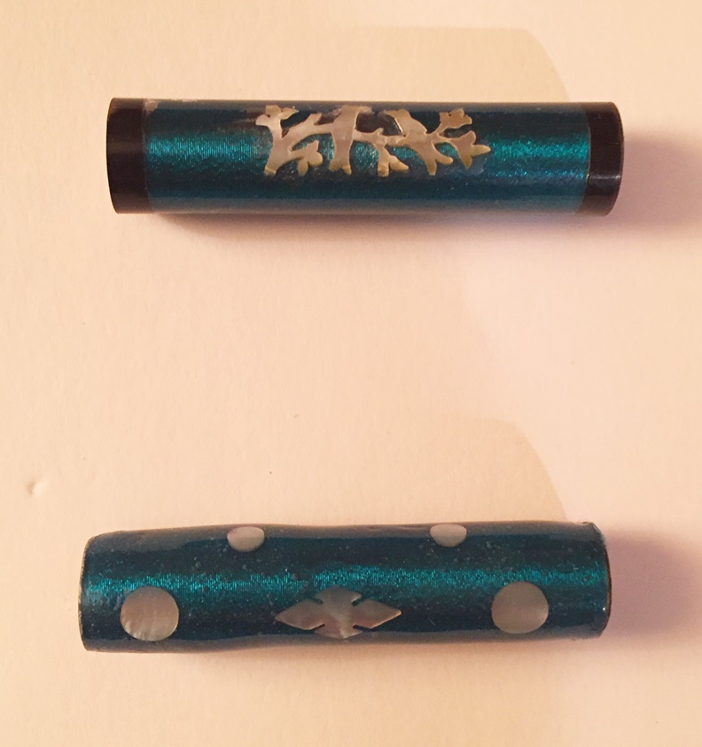

I usually try to have an indoor winter project for when its just too cold to be in the shop. After seeing some of the posts on thread wrapping, I thought I would give it a try. I'm far from doing the patterns but I thought single wraps might be another way to have a background for tube on casting objects. Here are a couple of my attempts of mother of pearl over thread which I had some hope to enter into one of the contests, but they just didn't make the grade. We'll have a real wrapper at our next Richmond penturners meeting and a demo at the MAPG if you want to learn more. In the meantime, here's a little inspiration...

Thanks for showing. The possibilities are endless using threads such as that. Simple designs just by combining colors or even the direction of wrapping. The overlays can really enhance them too. Good start. Look forward to more of this work.

Thanks! Any particular color sealer you like to use? I have been doing tests with the thread and abalone veneer. the veneer when cutting into strips creates bubbles in the seams, so I have been trying various methods to eliminate it.

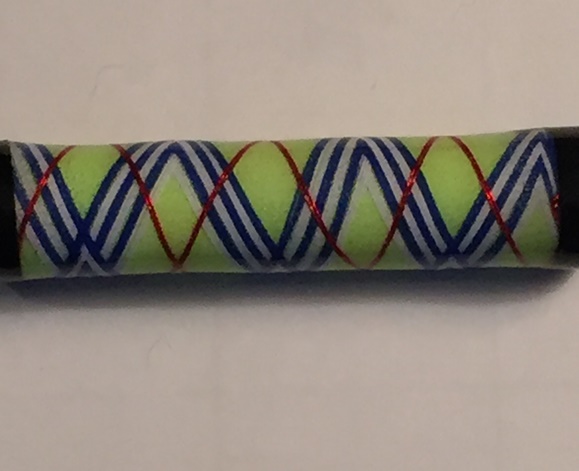

Also my latest using Prokote:

Thanks. For the Prokote, are you just slowly building it up layer over layer? Or casting like a normal pen blank after sealing with color lock, and turning down on the lathe?
So far, just building up. Think I can do with 2 layers which is what I would like. Tried the same with west systems but did turn after. I'm still in the experimental phase and haven't yet decided on my final process. Now waiting on more resin. Will post if I come up with a good process.
