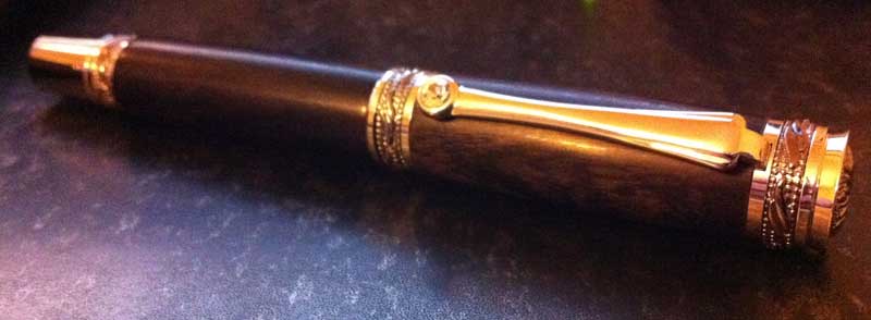

Here's the completed pen. Not bad for a newbie, right?

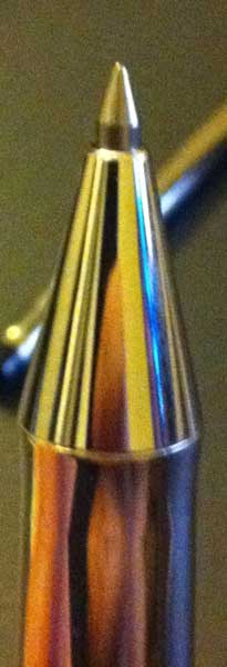

The MB refill will fit in the pen just fine, except that the tip doesn't extend quite far enough. It writes fine, it just doesn't look quite right. Looking at it, I found that the problem was the "shoulder" at the top of the MB refill body. The shoulder had to go.
The tip of the pen without modification.

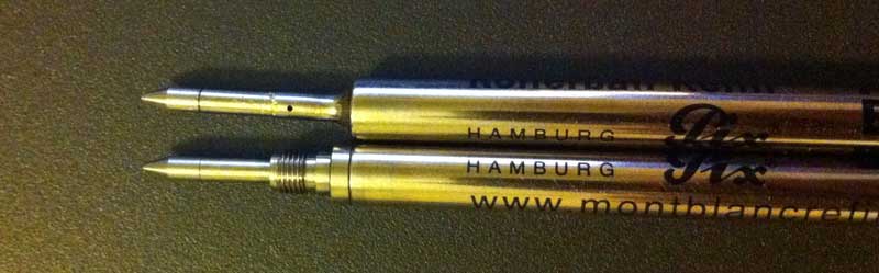

Compare the refill with the "collar" to the one without.

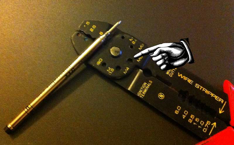

Figuring I needed something that would grab the shoulder piece and pull it from the pen, I grabbed some wire cutters. I thought that the way the tool works would be almost perfect for what I need. I was right! The shoulder came off without too much trouble. Once I pulled it off, I tried the fit of the refill in the tip of the pen and it looks great!
Here are the wire cutters, with a finger pointing to the part that did the job.

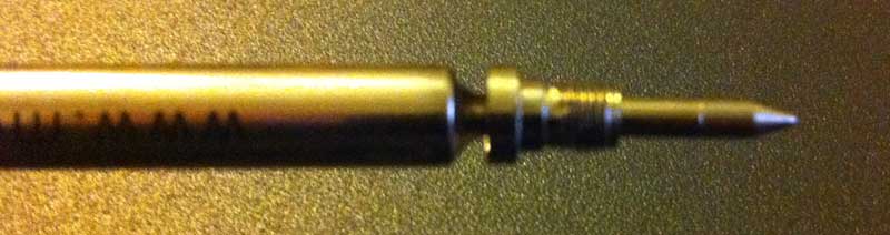

Here, I was pulling the collar from the refill. Almost done!

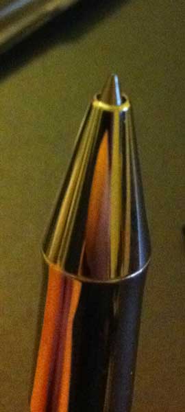

The finished product! Fits just fine.
