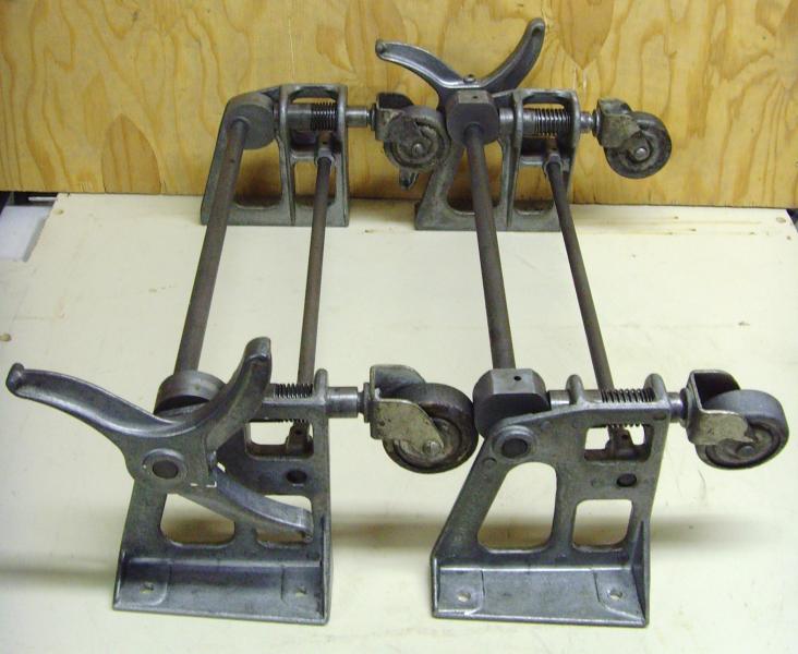

I had a similar train of thought. You could also use these:
SNV34330.jpg.
That's a set I sold a little while ago. Both styles let the tool rest on the floor when not in use, and lift it up when needed. Simple foot activation. I have both styles available, if you're interested

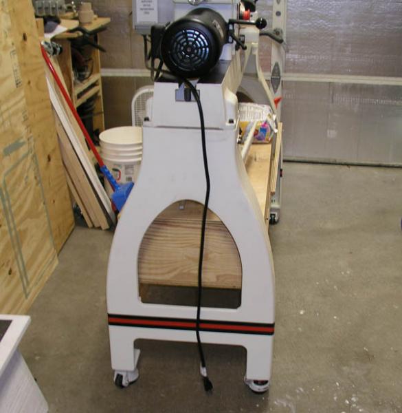

I have made a frame of 2X4 put the castors on them and then mounted the stand. It makes the stand a little taller than it would otherwise be but I think most of the stands are a little low anyway...works for me.

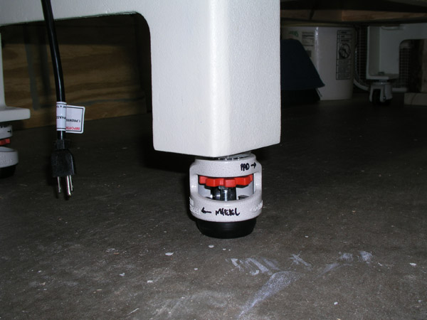

I just put these, Carrymaster AC-330, on my lathe and like them so far. They also help me level it out.

about 3.5". I'm 5'11" and the lathe was a couple inches low before I added the casters. With the 3/4" horse stall matts to stand on it should be just about right.
Yeah, I had to sort out how to mount them. The casters come with a removable 12mm bolt with an allen head in the end. I think I was suppose to tap the hole, thread in the bolt and use the nut as a stop nut, if that makes sense. I didn't do that, I bottomed out the bolt in the caster, used a washer and tightened the nut down. They also make a ratcheting version, but this one is simple enough to use.
