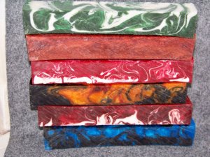

I think you might be adding your 2nd color too soon. How i do it is I pour my colors in seperate cups, add catalyst to both (i usually do 4-5 drops per oz.) and wait for them to gel (thick like maple syrup) and then pour both colors into the mold (you can experiment with how you pour) and I use a dental pick to swirl, make sure when you swirl to try and get the resin on the very bottom swirled as well so you get a good mix. If you have everything timed just right you will have good color separation. Here's how mine get if I do it right (which isn't everytime but I usually get it close):
both of the red/white blanks are what you can get if you don't swirl whats on the bottom. Good luck! and post your results!

You're waiting until it becomes mayonaise. You want to wait until at least the syrup stage, preferably the "Old Honey" stage. Looking at Bruce's picture, I'd guess the top Green/white one was done at the "Old Honey" Stage- see how large the lines are? While his middle (red/white) one shows much finer swirls- it was probably poured while the resin was runnier.

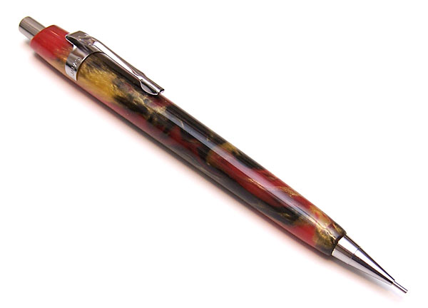

In a slab mold, alternate the colors pouring in single figure 8's until the mold is full. This pen was done that way with black, antique silver, and aztec gold. You can see the starbursts of color in the black due to a lot of blending on a flat plane.
Better Pic:

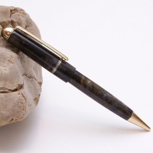

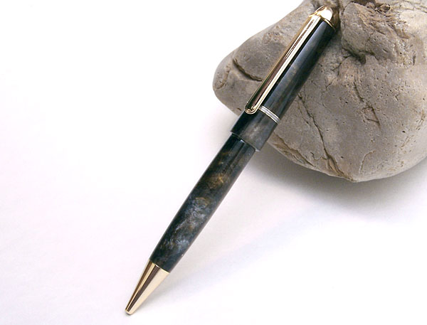

In a pipe, you alternate pouring 1/4" at a time (or however you want to do it.) Sometimes you get large smears, sometimes you get flame shapes.
This one is black red and yellow...
