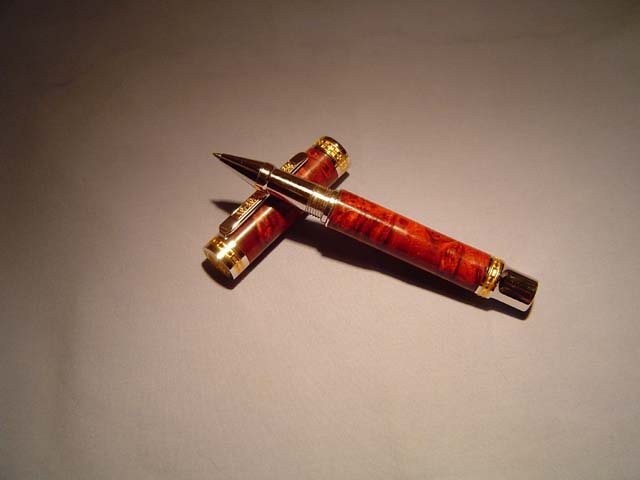

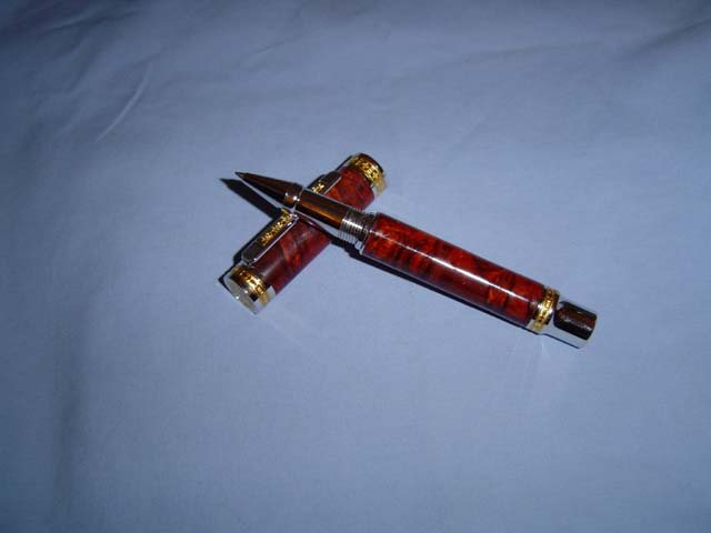

Heres picture no lights just flash. The flash has always gotten the actual colors, but with glare and never clear. It is a light blue cloth.
here is no flash and spotlight i have been using, it always changed the colors of everything, but gave the pictue a sparkle.

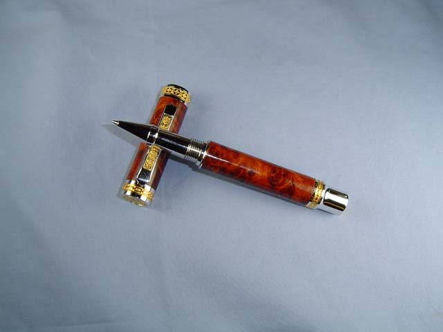

here is new light, not as blue, not as much sparkle, but a cleaner sharper picture i think.

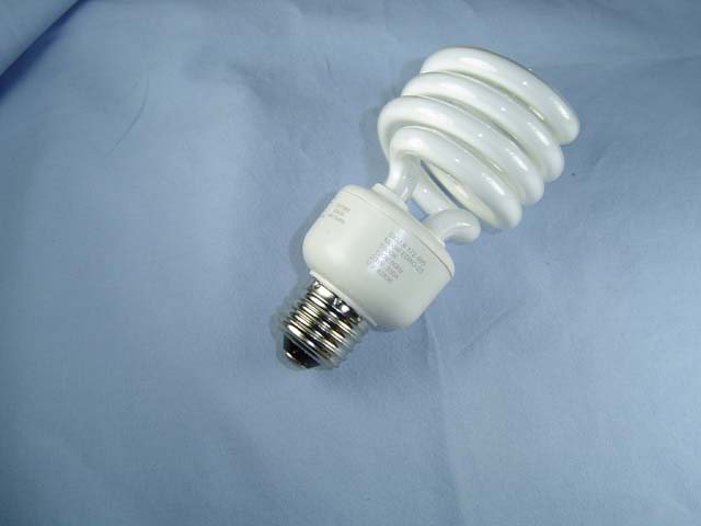

here it is a 90 watt bulb simulated day light
got it from home depot, but dont think brand name means anything
Try it if your having light problems with your pictures.

I agree that the last picture is sharper I can actually see the engraving of the fittings not just suggestions of them. none of the pen is lost in shadows either. Your first pic using flash looks really good for a flash photo as well. usually that does not work well at all.

Pretty good pics! Better than what I've achieved so far (hence my lack of posted pics). Does the package tell what the color temperature of those bulbs is? Something like 5000K or 6500K maybe? I saw some bulbs at http://store.tabletopstudio-store.com/spiral.html that interest me. They claim to be daylight with a 5000K temperature. Walmart has some that look exactly the same, some are standard (unlisted temp) and some are daylight 6500K temp. I know just enough about this stuff to be confused. [xx(] Anybody using any of these "trumpet" bulbs?
eddie
ah...haaa its 5500k, had to look up on line "color Temp" to see what it meant.
Some common examples:
1200 K: a candle
2800 K: tungsten lamp (ordinary household bulb), sunrise and sunset
3000 K: studio lamps, photofloods,
5000 K: electronic flash, average daylight. A designation of D50 stands for "Daylight 5000K" and is the most common standard for professional light booths for photography, graphic arts, and other purposes.
6000 K: bright midday sun
7000 K: lightly overcast sky
8000 K: hazy sky
10,000 K: heavily overcast sky
Those sound really good. The key to good lighting is the color temperature. GE claims the Reveal bulbs are "daylight," but if you really dig around on their website, you will find the color temp is only 3200K, basically a photoflood without the wattage. You can correct most of that disparity if your digital camera has a custom white balance setting, but it will still be slightly off. The other important consideration in lighting is CRI(color rendering index). The higher the CRI, the more accurate the colors will be. The highest I've seen is 93. The ideal bulb for product photography would be 6500-7000K with a CRI of 100. Unfortunately, nobody makes one.[:(]
