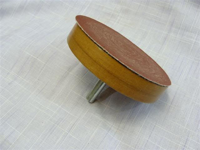

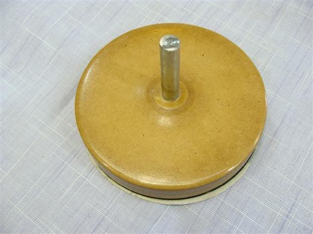

I made a mini thickness sander for making the thickness of segmented rings as accurate and as even a thickness as they are required to be for the best outcome of the segmented turning project into which they are going to be Incorporated.
Of course it could be used for many other small items where thickness sanding is important .
Here are pictures of it .

Way cool... Man, I need another drill press... My cheapie one can't do this - I've wanted a new drill press, but this gives me a good thing to look for when I look at them.
That is only a five inch disc using regular 5" ROS pads so you might be able to make it work on yours as long as your quill is a true 90 to the table in both directions.
The drill press shown is a big old 16 speed bench top model I bought from a newspaper add about 15 years ago.
LOL.. Not much true anything about my drill press... its a tiny HF junk... Theres a reason that I drill on the lathe :)
But its on my wish list.. and if I can remove a thickness sander from the list, maybe I can justify the drill press sooner. (crossing my fingers for craigs list!)
Awesome idea! I have a POS HF drill press but I have keeping my eyes open for a better one on Craig's List. May end up on my Christmas list in February from Uncle Sam.
