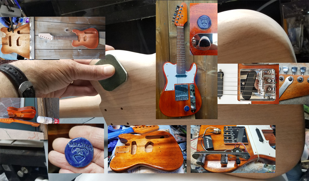

I couldn't resist making a mini-Telecaster - especially with a nice price drop at www.stewmac.com - here:

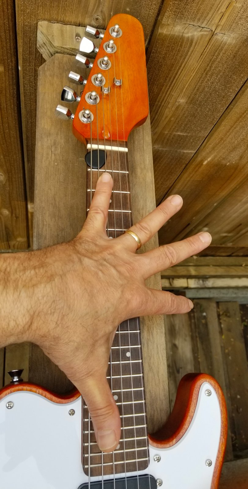

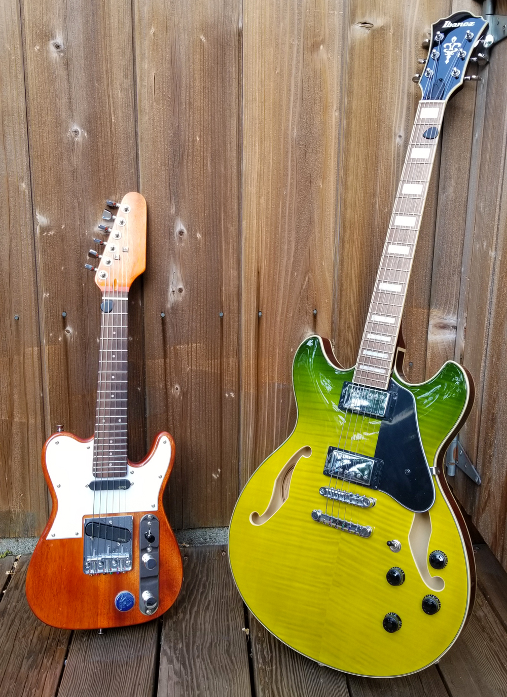

I did some body contouring with an oscillating belt sander, and did some additional routing to make room for EMG pickups; airbrushed the stain, sealed with 8 coats of nitrocellulose lacquer applied 24 hours apart, cured for 2 weeks, then re-sanded up to 2500 grit and buffed with compound. Next, I inlaid my logo, (which I drew in Adobe Illustrator, then laser cut into a stamp by Joel Socwell at www.4clay.com; logo impressed into porcelain clay, which I bisque fired, then glazed, then high-fired at cone 10 in a gas kiln) with epoxy putty. It's has a short scale length, so I tuned its flat wound strings up 5 frets (musical 4th interval) to A, i.e. tuned low-to-high: A-D-G-C-E-A. Great fun - plays like the wind, easy to finger otherwise difficult to reach chords, and easy to zip through single notes. It gets along well with its big brother (Ibanez AS73FMGVG semi-hollow body guitar) - show here for scale.

Angus - It sounds great with the (upgrade to) EMG pickups with flat wound strings - no extra noise. The active EMG pickups are a bit larger than standard Tele pickups, so I did some additional routing to fit the pickups in properly, and carefully routed some additional control cavity depth to fit in the 9 volt (1500 hour) battery without need to make a battery cavity on the back of the instrument body. I spent some extra time dressing the fret ends with files and sanding sticks to make it very finger friendly for rapid play. I also spent some time setting up the action (16" fretboard radius string height adjustment, pickup height adjustment, and intonation at the bridge saddles). I've played it through a rather large Peavy Nashville 112 that I use for lap and pedal steel guitar, an old Polytone Minibrute that I use for jazz guitar, and a Roland Cube that I use for practice and small room gigs - sounds great with all of these. I thought of switching from the top loader classic tele-style bridge to string-through-body, but there's plenty of sustain as is. I've tuned it to A, equivalent to a capo on the 5th fret of a standard scale length guitar, i.e. up five frets = up a musical 4th interval; and the pitches from lo-to-hi strings are: A-D-G-C-E-A; same inter-string intervals as usual: 4th, 4th, 4th, 3rd, and 4th. Hope this helps. Fun little build, with room for customization.

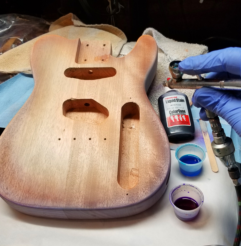

I sanded to 1000 grit, did not use sanding sealer, airbrushed ColorTone stains, but could have used any stain or paint; then did multiple daily sprays of nitrocellulose lacquer from a spray can; waited about 2 weeks for full curing; then sanded up to 12000 grit (many ways to do it).

Damnit Bob, ya got me. My tiny tele is supposed to be here Friday, as if I needed another project. Have you experimented much with airbrushing stains and finishes outside of this project?
Nice MiteyF!
I've thinned the StewMac ColorTone stains with isopropyl (rubbing alcohol) - with plenty of ventilation, respirator mask, etc.
I've also airbrushed a lot of Dye-Na-Flow colors right out of the bottle - great color assortment.
