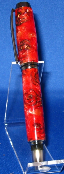

This is one of the pens we have made out of them. They like like little roses when turned

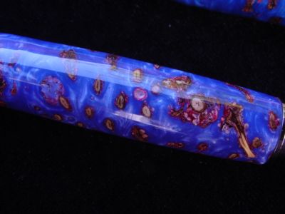

Here is another example of a redwood cone they are small enought that you can make a blank out of 4 or 5 of them.
