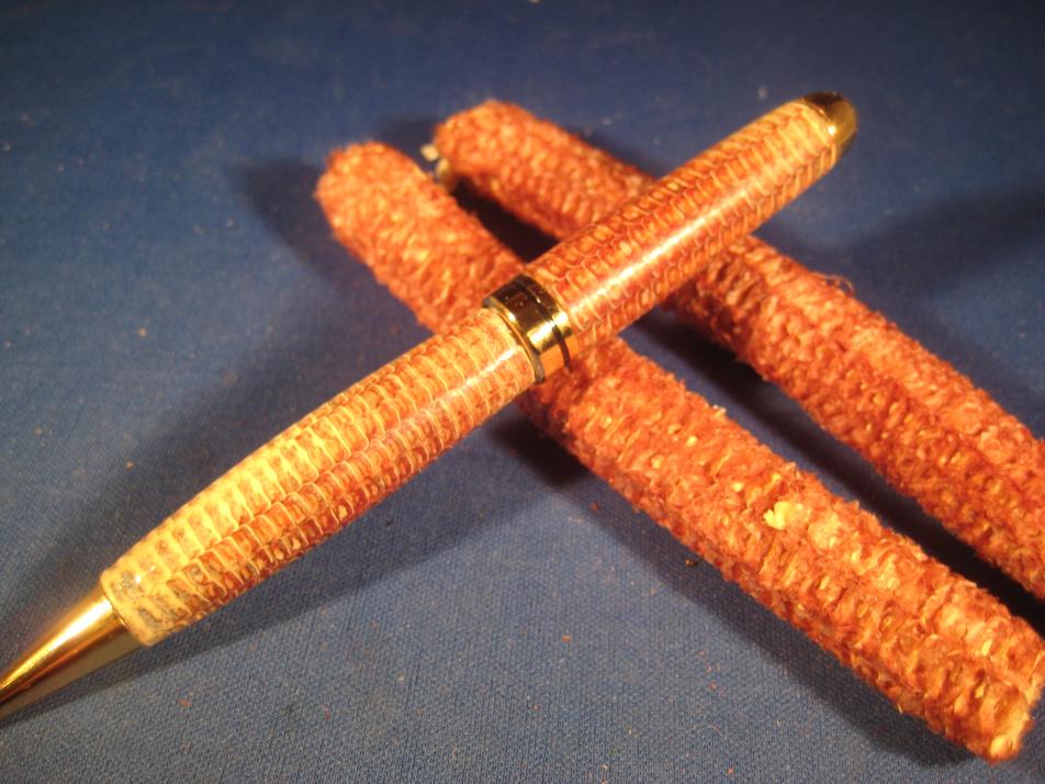

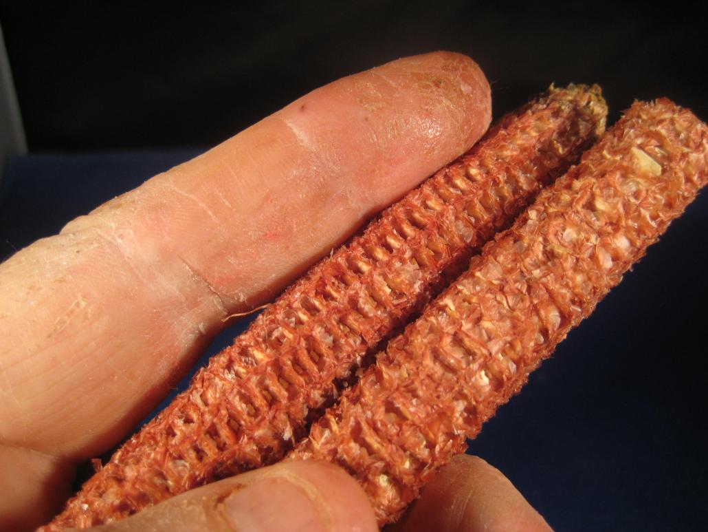

One of the members sent me some miniature corn cobs several months ago. I exploded 2 just drilling them out so they got put up for a while. These cobs are about the diameter of my index finger. Well, Being extra careful, slow and using almost lazer sharp tools, I got one finished. These smaller cobs retain more of the red chaffe when they are turned to size. They don't polish up as good but they look a lot more like a real corn cob. Take a look.........

Cool looking cobs!Looks a little underturned at the nib end,but that could be the photo.I think you are right they look better than the normal sized ones I have done.
I'm amazed you were able to drill them. I gave up after blowing out two. I even drilled straight down the middle and the only thing left was chaffe. You must have had some larger sized ones. Great job!
I really like the look of the corn cob style...and how it looks much more like an actual corn cob then the larger ones. Great job, and way to stick with it and be persistant.

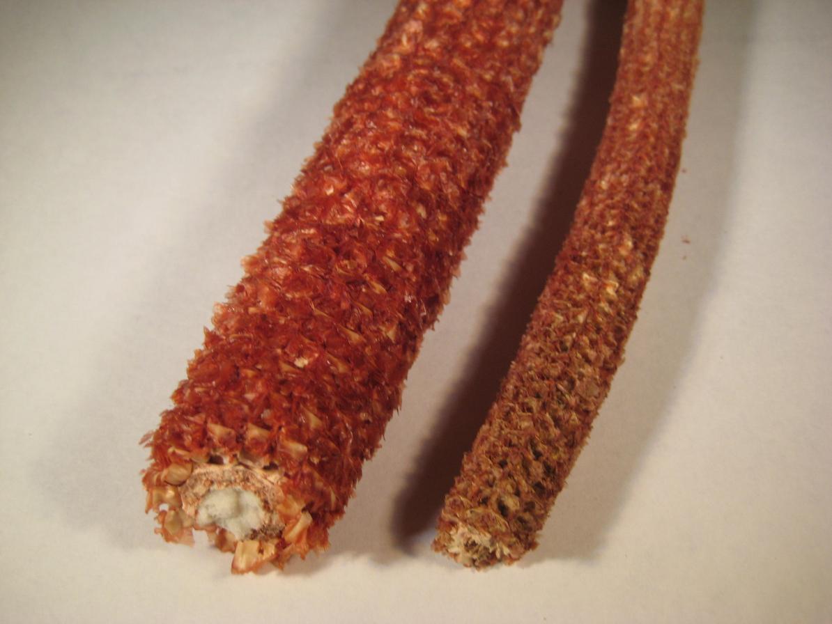

I have to settle for sharp tools. Thanks to Parkenson's, the steady hands are gone. Some days are better than others but most days I can hold a glass of milk and make butter. It is really annoying but it might be something worse. These little cobs are a real trick. I blew 2 more this morning just trying to drill them. Got 3 left and tomorrow I'll try again. Wish I could remember who I got the little cobs from so I could get some more. If anybody has a half dozen or more, let me know and I'll buy them or do some trading. Look at the difference between reg and mini.

Those are very nice! I think I would try to cast in clear pr before I turned them. It might help with the blowouts. I live in corn country, and Ive never seen cobs so skinny.

The glued in tube really helps hold everything together and from there it is sharp tools and thin cuts. Work the edges down to the bushings a little ahead of the centers of the sections. I start with a 3/4" gouge and switch to a 1" skew to finish up. Also sandpaper removes cob in a hurry so leave it large and take it to bushings with 220 grit paper. Get finished with 400 grit and give it 2-3 coats of thin CA. That will stabilize and then I go back to 400, 600, 1500, 2400, 4000, 6000 and then I finish with 5 coats CA/BLO.....about a minute with 12,000 MM and then Ren Wax. Then on to a Bud Lite.

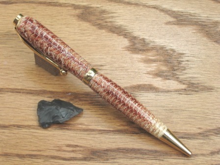

George, I`m the one who sent you the pencil cob corn cobs.I`m glad to see the results it really looks good. Here are the steps I go thru when I turn one. Normally i do a slimline due to the small diameter of the cobs. First I soak it with thin CA,let it set for at least 24 hrs. Next I drill the hole and pour thin CA down the hole and let it set another 24 hrs, next I redrill and cut to length and turn. While turning I stop and re-soak with CA as I feel need to. I blow one out now and again but not too often. Finish with CA. I hope this helps. Here`s the last one I turned.
