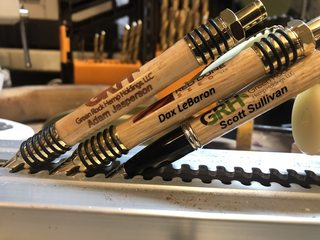

I have recently decided to stop using MM and really can't feel a difference in the finish. I use my normal method to make the blank and sand to 400. I don't really see a need to sand to 600. I use GluBoost and apply a few coats of "Blue" fill and finish then use .0000 steel wool or 600 sandpaper and blow the dust off with compressed air. When applying the GB I have the lathe off and wipe in straight strokes across the blank making sure to not turn the blank while I am wiping which gives a much smoother finish. I only make one or 2 swipes across each section because ridges form as the glue dries, with GB accelerator after each coat. Then the same technique with 2-3 coats of "Orange". Not one pen with any frosting or bubbling in the finish. I wait a few minutes for it to cure then depending on how it feels I use 600 or steel wool again then, again depending on how it feels I'll use EEE or go straight to Plastix polish. Quicker, dryer, less mess and same results IMO when I compare them to blanks that I made using MM. YMMV, but I just filled a 30 pen custom order with decals and engraving and was able to turn and finish a blank with a decal in less than 15 mins. (plus engraving time for the engraved blanks).
A few examples. Sorry about the focus being a little off.
