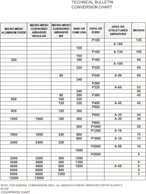

What an interesting coincidence!! I just emailed Jeff a copy of the MM chart that shows the grit equivalent between MM and sandpaper for posting in the IAP reference library. I'll post it here too just for reference. Note that 1500 grit MM is about the same as 400 grit sandpaper; but as Steve mentions the scratch pattern will be different so a 1500 MM sanding will be nicer than a 400 grit sandpaper finish.
